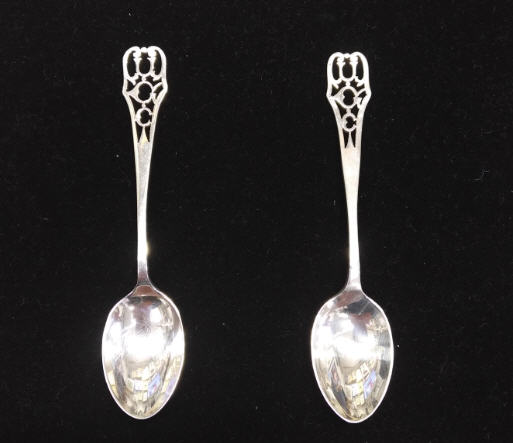

Can anyone help me on a Monday morning ? This was my first customer :Slap:
A lady from the golf club wants to display 2 silver teaspoons in a frame but wants to be able to take the spoons out and clean then in the future, that's when my heart sank.
As you can see in the photo below, the spoons could hang vertically but I couldn't use mylar strips or thread as that would be permanent, can you think of anything that might allow them to be lifted out ?
Any suggestions greatly appreciated.

Hi Adam
You could try some of these Mighty Mounts from Lion , not invisible, but you can't have everything :sweating: :nod:
https://www.lionpic.co.uk/p/9207/Mighty ... Pack-of-12

Cutlery often comes in presentation cases where all the items fit on a moulded base - mostly flocked.
The thought occurs that it you get a set cheap enough to cannibalise it to cut out the space for two spoons
you may be able to adapt it to the job. And use the implements for eating purposes. :lol:
Sorry for lame answer but invisible pixies to hold them are hard to find. :roll:

Hi Adam,
You don't need to make them detatcaible for cleaning. Picreator produce a wax which forms an invisible gas impermible barrier which will seal the surface of the silver spoons to exclude the contact with oxygen that enables to silver to tarnish. Not oxygen meansno tarnishing - Easy when you know how! This wax is called Renaissance wax.
https://picreator.co.uk/renaissance-wax/
Now you can impress your customer, with your knowledge of museum grade protection and the protection of silver from tarnishing.

I used to used mono-filament nylon for fixing things like this. I got the mono-filament nylon from "Empress Mills" a company, based somewhere in the north of England, but now I use a variety of Nylon and Polyester tags as used for Garment price tag guns, which I got from "Morplan". Some of these tags are something like 5, or 6 inches long as pretty much invisible to the eye, which viewed behind glass.
I find that these longer tags are much easier to handle than the mono-filament nylon and usually don't resort to the mono-filament nylon, so much so, that I don't even know where my mono-filament nylon currently is a the moment. I quite often use these tags also to hold medals in place, especially when there are grooves around the stems of the ribbon hanger, where the tag will seat into the groove and be almost completely hidden from view.
I have framed knives and forks before also using these tags. I bought a set of six pair of antique looking knives, for a local charity shop for £1 for the whole six and one knife and fork got framed as something interesting for in the shop window.
