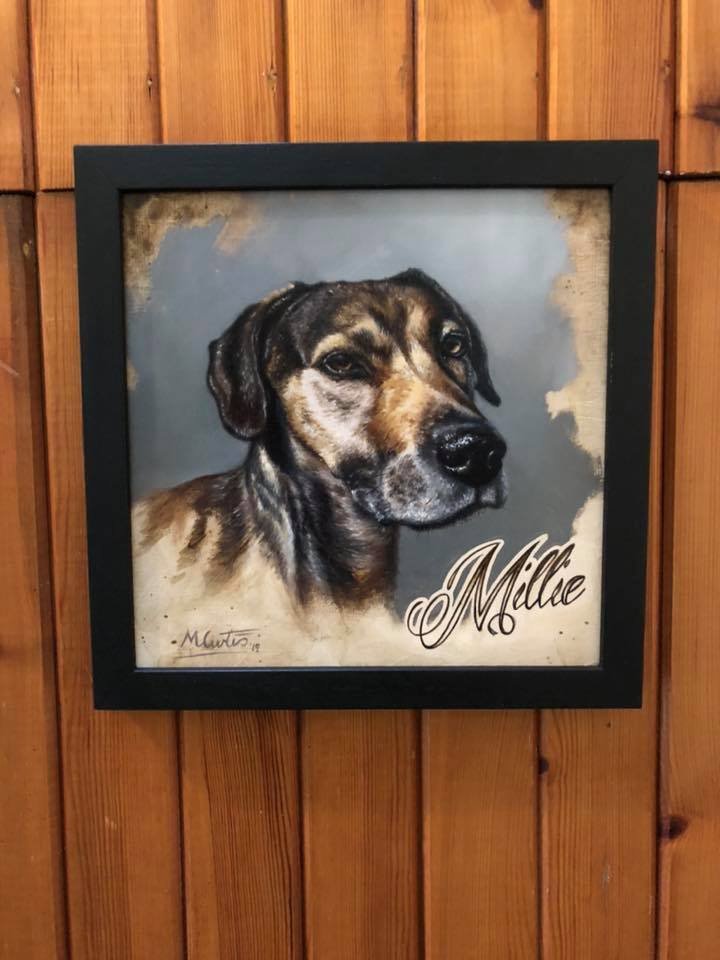

Hello all. I 'd imagine this isn't of huge interest to many, just a simple frame hand finished in black acrylic then waxed... but this frame is the first frame I made and earned money for!
Frame measures 260x260mm and I charged £40 for it. I have no idea what to charge yet for framing work and since it was for a friend, that's the price that I came up with. Would anyone tell me roughly I could have asked for?
The painting is by me too.
Regards
Matt

Not your average framer wrote: Sun 01 Dec, 2019 7:37 pm I don't know why, but I can't see the image.
I couldn't see it either, but I've reposted the image in case that helps. I can see it now, can you see it, Mark?
It's a great painting of Millie, I'm very impressed :clap: What medium have you used? I only ask because it doesn't look like oil on canvas but there's no mount so I just wondered.
Orde02 wrote: Sun 01 Dec, 2019 6:19 pm Would anyone tell me roughly I could have asked for?
It's a great feeling when you make your first sale, isn't it! I don't do hand finishing myself but my gut feeling is that £40 seems a bit low for the amount of work that has maybe gone into it, but I could be wrong.

Hello Rainbow. Thank you for reposting the image. The painting is actually oil, but it been painted on masonite rather than canvas. I cut and gesso all my own boards for painting on, I just prefer it over canvas.
