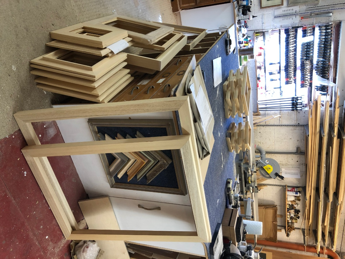

My benches are typically made with 2" X " timber which has been cut of the Morso and glued and screwed at the corners. The corners are cross braced to keep everything solid and the bench tops are 18mm chipboard, or MDF. As a rule, I like to make everything that I need, including shop fittings myself and often re-purpose good quality secondhand wood. I am well equiped to handle almost any woodworking task and can make it look totally professional. If you have the time, maybe you could do something similar youself. It would save you all lot more money, if you can do it your self.

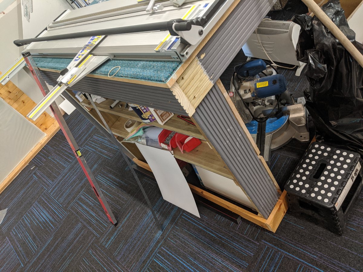

When I moved into the shop, it was a mess but the previous owner had a wall display made from decking. I just ripped it off the wall, cut it up and joined it again in the shape of a workbench X2. The moulding storage was made from ideas that I gathered from this very useful & knowledgeable forum

Re: New member and would be grateful for some assitance!
StevenG
I think the decking gives it a very neo-classical look, very posh

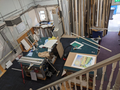

Yes, the staircase indeed, it's where I keep my smoking jackets & booze, I usually have the staff bring customers into the workshop once they're announced I slowly descend with my monocle & glass of gin as I wax lyrical about mount widths or maybe I use the upstairs for storage & tea makingcleaver wrote: Thu 21 May, 2020 11:49 am I also love the recycling you did, Steven.![]()
WOW! Looking at the inside of the roof, I can see that it is an industrial unit, but the way that the inside on been fitted out, it looks much older and far more stylish. I love the way that you have given a run of the mill industrial unit such a really homely feel. Such a great atmospheric place to work and such a spacious feel too. Adding that stair case and banisters is nothing short of inspired! I bet you really look forward to going to work.
I think perhaps, a real inspiration to the rest of us!
Neo-classical workbench motifs, panoramic staircase...now you're just rubbing our noses in it, Steven
What a dream of a workspace - good for you, amigo.
