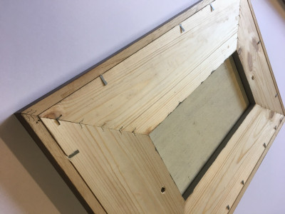

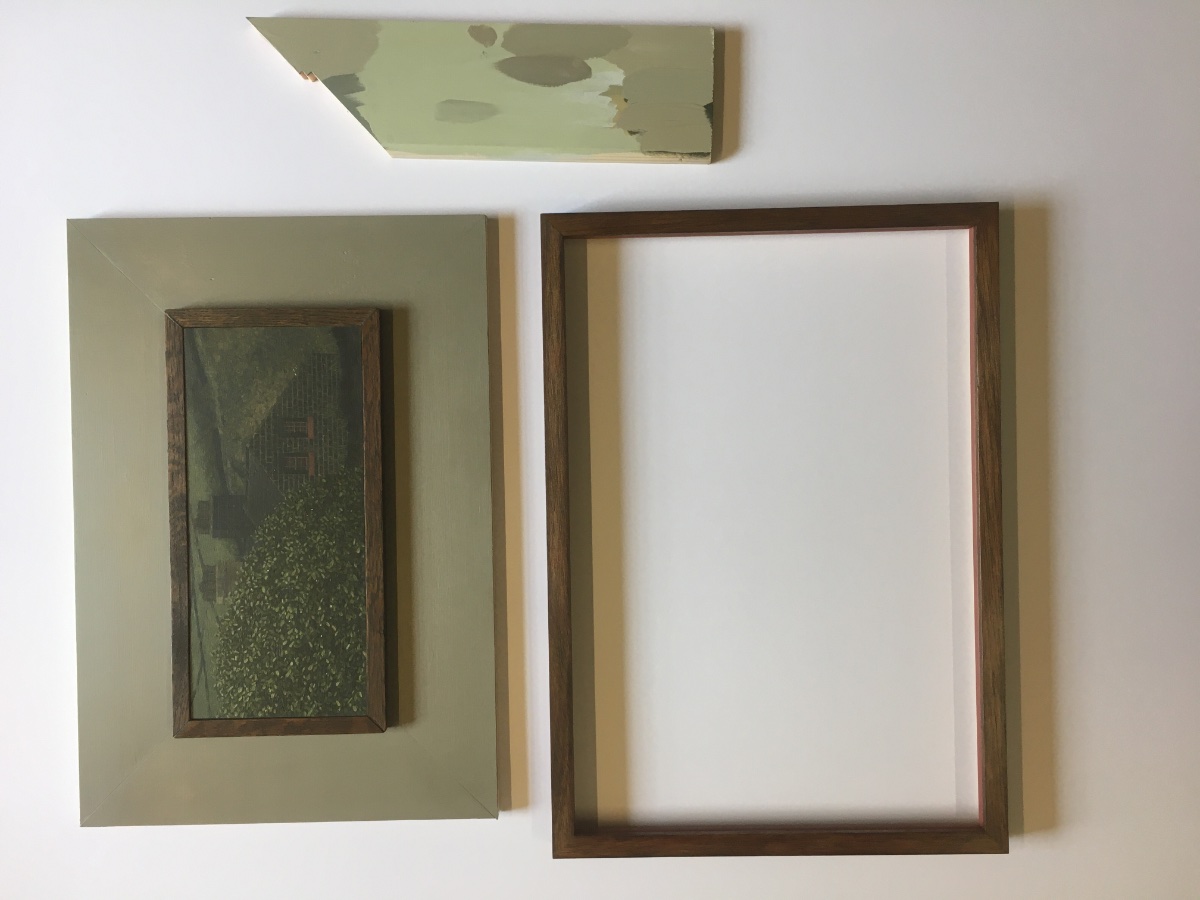

Hello,
I am very new to framing - which is why I’m struggling to price some of my more bespoke customised frames (teaching myself completely in a bubble) as I know I’m spending way too much time (learning curve etc) to get them up to standard, and I don’t have anything to compare to. I don’t want to be unfair with my pricing just because I’m not up to speed.
I was wondering if the more experienced framers out there could tell me how much time they would probably spend to have achieved the same frame, and about how much they would charge. (I can work out myself based on materials etc but the thing I’m struggling to guess on is time.) I’d like to charge a fair price.
The job in hand was to showcase this miniature painting and its old frame. I have constructed it from scratch, hand varnished and waxed to match tones in old frame, hand mixed/colour matched the paint on the wooden backing mount which I made out of raw timber, and hand mixed/painted waxed the fillet.. screwed in the back through the holes on the old frame that were already there, so minimal interruption to the original piece.. 400mm w x 300 h.
Really appreciate any tips, also if you’d do anything with the frame differently, I’d really value any feedback. Im learning from manuals, books, YouTube, and reading through this Forum.

Firstly it looks great. There is obviously a lot of time involved in your current processes. Personally I would substitute your timber backing with painted 5mm MDF which will prevent the mitres showing through. The MDF could have a mountboard glued to the front, saving you that part of the painting. That timber backing looks very precarious to me. I would use flat canvas offsets to join the two together rather than points(points would probably be fine with mdf though), they just don't look secure enough to me like that.
As far as time goes, break down your processes into a list and decide how long each process should actually take eg stain 5 mins, wax and buff 5 mins so 10 mins at £x/hour. I went through exactly the same dilemma when I started and set a standard hand painting charge (according to size) for the time I thought it SHOULD take, based on layers and finishes. I would suggest that at this point you need to make sure that you are making enough money on the job. Later on you will start to make money on the time.

I'd be thinking of a price around £150 or a bit more maybe.
Nice work.

My price would be around £200 but that includes VAT, so around £160-170. Like already suggested, i would use mdf for backing, either 6mm or 9mm.
I remember when i first started, i was often apologetic about the price when speaking with customers. It is all about confidence and not worrying if people walk away if they think you are too expensive. In fact, if you don't have anyone deciding you are too expensive, your prices are definitely too cheap.
At the moment in particular, you will also need to regularly keep an eye on costs and review prices. Glass costs have soared recently and timber prices have been going up too.
