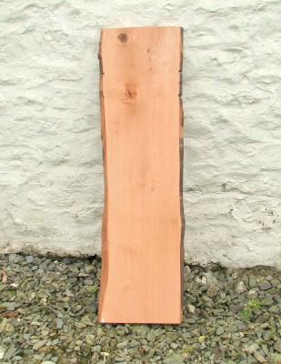

Thanks Nick for mentioning Interesting Timbers. I used to go there, when I lived in that region. That's where I bought the best book I've ever read on frame making - Framing and Gilding, Paul Curson. They also had really good quarter sawn oak boards.
Yes Mark, Pear wood is quite limited to find and only in short lumber
Here's a board that arrived yesterday, just over a meter long -
