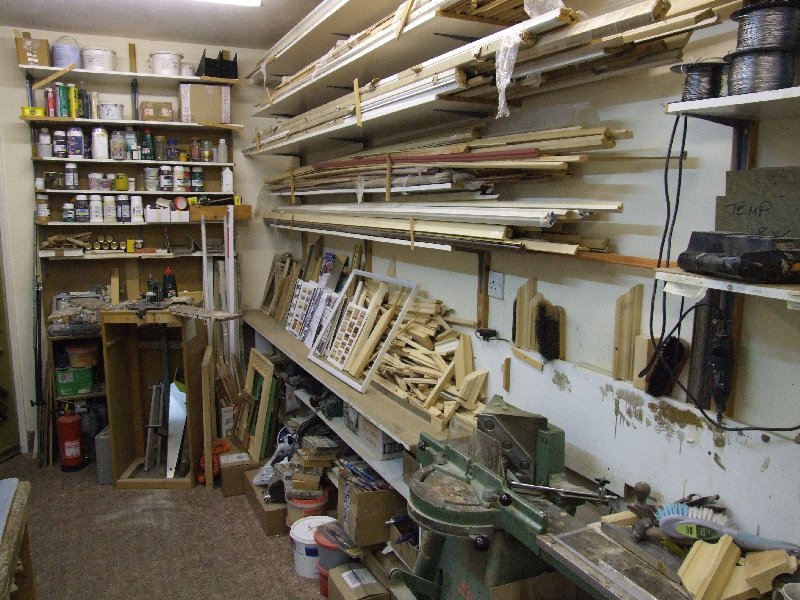

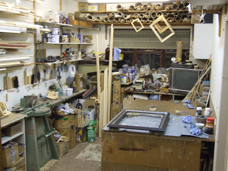

This is after I tidied up.
To be fair, this is a 'mucky' workshop where I do all frame-making and hand-finishing. I have another clean(er) room for mountcutting and assembly. But there would be room for mountcutting gear and mountboard storage with no hand-finishing and better housekeeping.
Somewhere under all the crap is a compressor and a hardbed press (unemployed).
btw. The ceiling is 8'6". Over the door there is room for two shelves for moulding as well as the ones near the Morso. I keep the most used stuff there. There's more in my 'warehouse'. (caravan).
