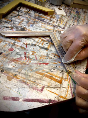

Thanks Jeremy for a great day out yesterday on your hand finishing course.
Plenty of hints, tips and expertise. Lots to think about and experiment with. A very relaxed day with plenty of tea and banter in your impressive workshop!
I experimented on loads of different types of mouldings and I attach just a couple of piccies of the day.
Thanks again. Geoff
Thanks again. Geoff

I like the pictures, are these from the course? Really great work. Nice!

Hi Jeremy,
I paticularly liked the cornflower blue distressed moulding sample and the ribbed sample below to distress blue one. Are these moulding, which you added the distressing and machined ribs to yourself? I'm really impressed with how these look. Such a great result and both look fabulous. The colours are very effective too! Too be honest, I had some ideas of creating similar things myself. I have a rotary wire wheel on a small angle grinder and could possibly create a similar distress effect as on the cornflower blue distressed sample, using something like that. It's a very nice, professional result, which I would guess must be something, which sells well.

Thanks Geoff, glad you enjoyed the day. I look forward to seeing some more of your work!
The examples above were Geoff's own creations so I can't take the credit! The 'cornflower' blue one was on a rough sawn pine moulding very similar to R&H A284, and the ribbed one is R&H A64 oak.
I teach the processes, and demonstrate a wide range of finishes, and then each delegate gets the opportunity to produce their own versions.

Well done Geoff,
Your rough sawn cornflower blue sample is really nice and such a great idea. I was really impressed with how you have produced such an evenly spaced range of bands in the finish. Can I ask if that the result of a careful technique, or just how it turns out. Just Beautiful!

Hi Geoff,
Can I ask if you rough cut the wood for the distressed cornflower samples yourself, or if this is one of the rough saw mouldings which some suppliers sell.

Thanks for your compliments Mark.
The samples were already cut for us on the course and they were fairly rough with the evenly spaced markings already there.
I painted on the blue liberally to the front face then sanded it smoothish. I added on a green wax and then used some clearer waxes to give it the variation in tones. I then painted the sight and back edges of the moulding a solid blue.
Then a good polish up. Voila...

Thanks Geoff,
I think that it really looks great!
I like to save myself a bit of trouble. I was born with a right handed brain and that is still what I've got. Unfortunately my stroke has really messed up the right hand side of my body, including my co-ordination, strength and speed of movement and I need to cheat a bit with electric machine tools to still be able to cope, but in spite of all that I'm still getting impressive results. My favorite wood for rough wood effects has got to be Oak, it just looks fantastic.
I generally go for a subtile aged effect. Too much, does not look genuinely aged. I like a combination of tinted Black Bison wax applied sparingly with a small paint brush, followed with a sort of warmish pale grubby wash, which is then sealed with Polyvine Acrylic wax finish varnish. It's not a heavy finish, just a very thin one, which allows most of the texture to really show through. I don't always like knots very much in Pine, but knots in Oak is often another matter. Oak can look really great with a few knots, as part of rustic finishes! I get quite a lot of a very economical 20mm wide oak and there's often some useful sized off cuts which get used for producing frames to display for sale in one of my shop windows.
Rough sawn Pine, or driftwood wire wheel brushed Pine is great for pastel coloured finishes. I suspect that customers assume that Oak frames will cost more, because Oak is more expensive, but not all Oak is expensive to buy and I know where to get the nice and economical Oak mouldings from. I try very hard not to waste any off cuts, or waste bits and pieces. Odd bits of some mouldings can be like money in the bank! I would rather produce larger off cuts, than off cuts which are too small to be usable, if there is no significant financial sacrifice involoved.
