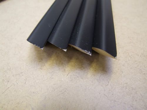

An example. Had the pics for a while as I was intending to rant but never got round to it.
After much experimenting I found that a postit note placed between the fenc and the moulding helped but the bottom edge was so brittle the slightest touch broke off a section.
