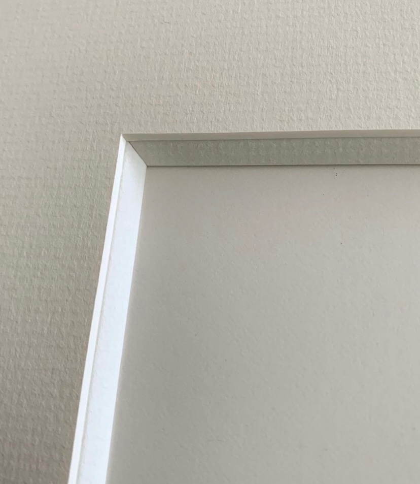

I'm sure this has been asked before, and I'm certain the answers will be varied, but I'm wondering what are the most popular 'white' mount boards. I've always mounted and framed my own work and hayseed has always worked well for me, so much so that it's all I've ever used. Now that I offer bespoke framing, I'm finding that hayseed is actually too creamy for lots of people - and paper - and white mouldings. Bright whites don't sit well with most papers. I have the full range of mount chevrons from Larson Juhl and Centrado (their own brand), but none of these are quite right either.
Larson Juhl's 'Glacier' is maybe the closest I've found within the chevrons I have as it's a tad less creamy than hayseed. I have a print at home that has a lovely white mount on it, but I have no way of knowing what board it is. The only way I'd describe that is 'milky'.
Here is one of my prints mounted with hayseed and you can see a 'pure white' mount just doesn't work.
So I know everyone will have multiple whites, but do you have a 'go to' white that you use more than any other? One that works with more papers than others?

I have lots of different whites to offer customers, but no matter how many you've got, there are some jobs where none of the white mounts look great against a painting with a white background. When that situation arises, a double mount often solves the problem by separating the white mount away from the white background of the painting. If the customer doesn't want a double mount, a black-core white can also help to remove any clash. If the customer is amenable to a coloured mount instead of white, that can work too. I realise that this doesn't answer your question of "which is your go to white", but that's not the way I would look at the problem of clashing whites.

Thanks for the reply Rainbow, and for the compliments on my work! I see what you mean and a double mount is a good idea. I usually double mount using the same board, but I can see how a different colours inner mount would separate it.
The paper I print on is classed as 'High white' but it's still very creamy when held against a pure white mount. I've never had an issue with Hayseed but I've noticed since framing other people's work, many find it too creamy.

Glacier and Hayseed are my go-to whites.
I also like Dawn Green (which isn't remotely green) for a greyer look and Chocolate Sunrise for more 'wheaty' tone.
You are right to be picky as if any bare paper is visible on the art then the mount colour can throw it all out of whack.
