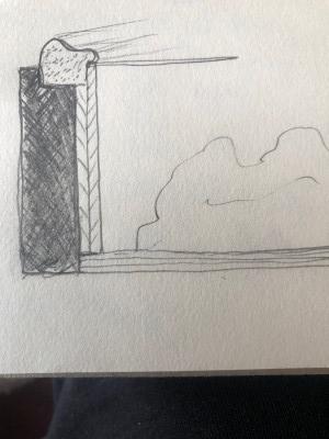

Maybe a bit of terminology confusion above but there are two methods of doing glass spacers, pinwheeling and Stonehenge.
Both have pros and cons - Stonehenge, well it worked for Stonehenge! Sides need to be cut pretty anally accurately
Pinwheel - measurements can be eyeballed really, only one end of each spacer butts against another, more possibility of failure - but if done right you’d be very unlucky - and the sides on the Stonehenge method have no support anyway, just the top and bottom.
Arrows on pinwheel method show play in corners
