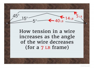

I only use the size of frame for small pieces with a sawtooth hanger at the top. It is really the weight of the glass that is the issue. I have had a number of skinny framed pieces in for reframing over the years. The issue being that as the bottom rail sags, it exposes the bottom of the glass and puts incredible strain on the mitres. My issue with this moulding is even with a Rose and Hollis dedicated subframe moulding, there is only 8mm to screw into and accuracy would be critical to not screw through the side face of the frame. The d rings and cord method has been discovered used in the past but is considered unsuitable for modern framing techniques. I have on occasion in the right circumstances cut some fillet wood and fixed with flat canvas offsets centre top to bottom but again with only 8mm this is still tricky. Personally I wouldn't be happy solely relying on staples through mdf as the staples may or may not have sufficient purchase and I like to think that my work is good for 20-30 years!
It is also important to understand the forces in action when hanging frames. Here are two illustrations that you might find useful.

the diagram of the angle of hanging cords very interesting, will affect how long I make the cord in the future definitely.

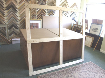

by prospero
The elegant solution for making BIG subframes. Get some tongue and groove pine cladding. It's (relatively) cheap
and comes in 8mm thickness. Rip off the tongue side.
The clever bit is you can form half-lap joints without any fancy woodwork skills. Just use two layers, glued and screwed.
The laminated construction makes it very stable and the whole thing is very strong. With a bit of cunning you can engineer
a cleat system into the subframe by slicing the inner top rail down a tad to form a cavity which engages with a wall batten.
I have a 4x3' mirror in my bathroom hung like this. It has a ½" beech moulding around. It's solid as a rock. :P
This was behind a big map...
