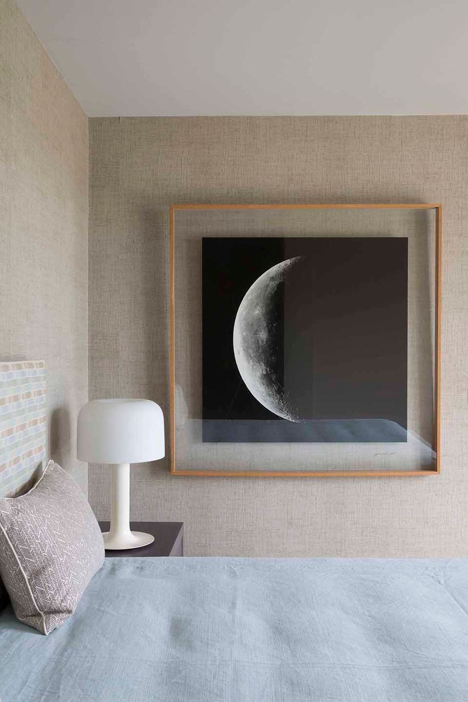

I have found one example online of a frame with one side missing: https://ik.imagekit.io/theartling/prod/ ... g?tr=w-950
And another of an artwork mounted with a transparent surround: https://ik.imagekit.io/theartling/prod/ ... g?tr=w-950
I found them here: https://theartling.com/en/artzine/how-t ... r-artwork/

I don't see how the translucency of the film would be seen once against a wall; wouldn't there need to be a light source behind it?
Also not wanting the sides framed, well, acrylic or glass sides will show, just look at the cut edge of a piece of either, plus there's shadow to consider, so you'll definitley see the edges of the whole thing, plus top and bottom bars larger than you would otherwise need.
You can buy tiny but strong aluminium mouldings that would be overall far less conspicuous.
Assuming this translucency can be seen against a wall with glass as a backing, then you can mat and mount the atwork in the normal way, but back and front, and glaze the back, or don't use a mat on the back and mount the artwork to the back glazing. Then the skinny aluminium frame. That would be my £££££££'s cheaper, far better looking (IMO) and just as effective suggestion.
