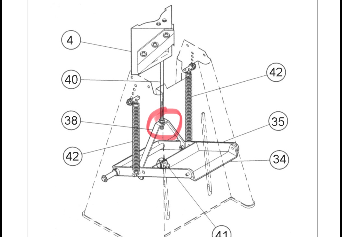

Hi I have a Morso EH that serves me well. One think I notice is that when the cut is through the moulding it almost sounds like it is bottoming out. Is this normal ?
Should there be no noise when it has actually cut through the moulding and is just before returning up?

Hi, not sure if same based on your description but I had an issue with a clunk at bottom of cut before returning and was a loose bolt on where the draw bar meets the bow bar
Ill
Hope this attaches
Regards,
Allan

Thanks Allan. I'll have a look in the morning. Cheers for making the effort to get back.
