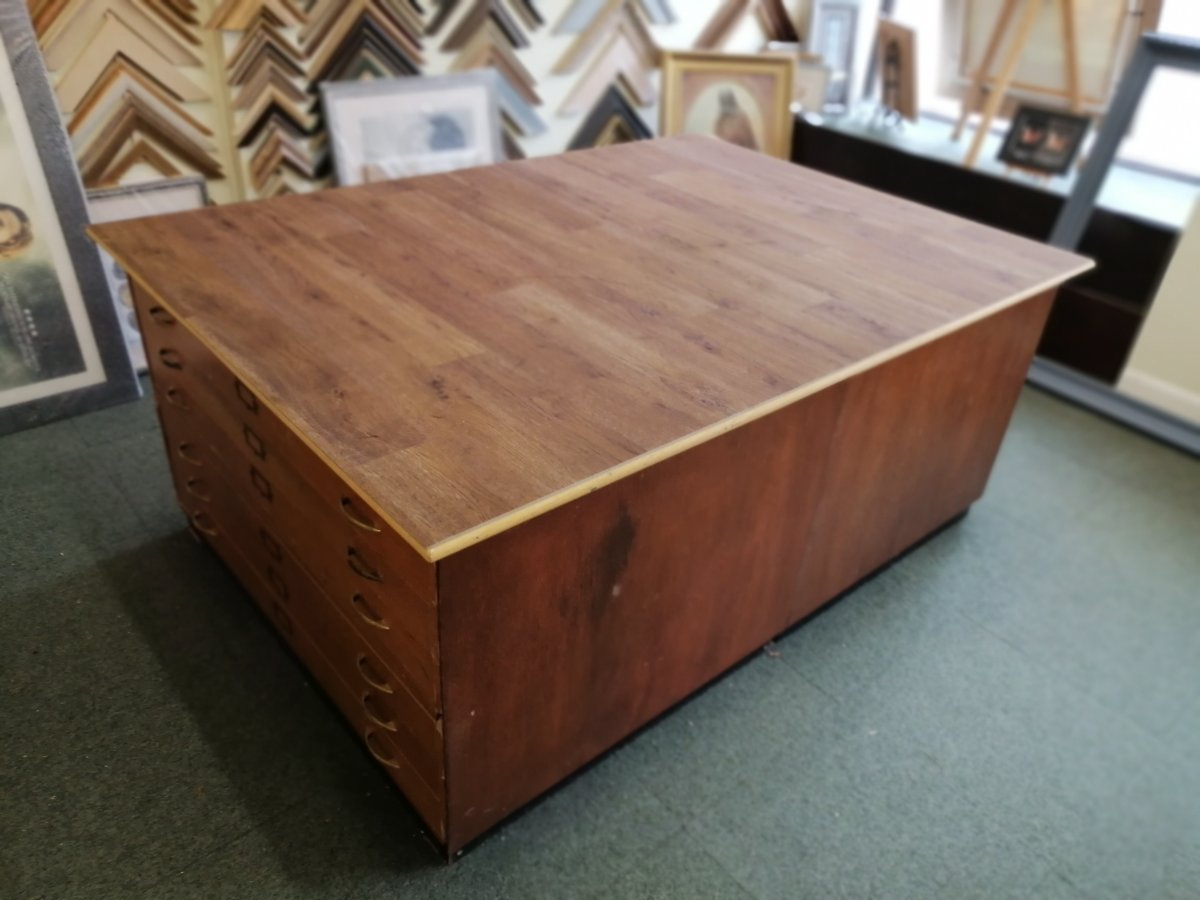

Two plan chests back-to-back topped with 19mm chipboard faced with Flotex carpet. Idea for final assembly.
I have a similar one for the mount cutter and an A0 drawing board with a cutting mat on it.
In another room I have a 6'X4' peninsular bench for frame building/finishing.
