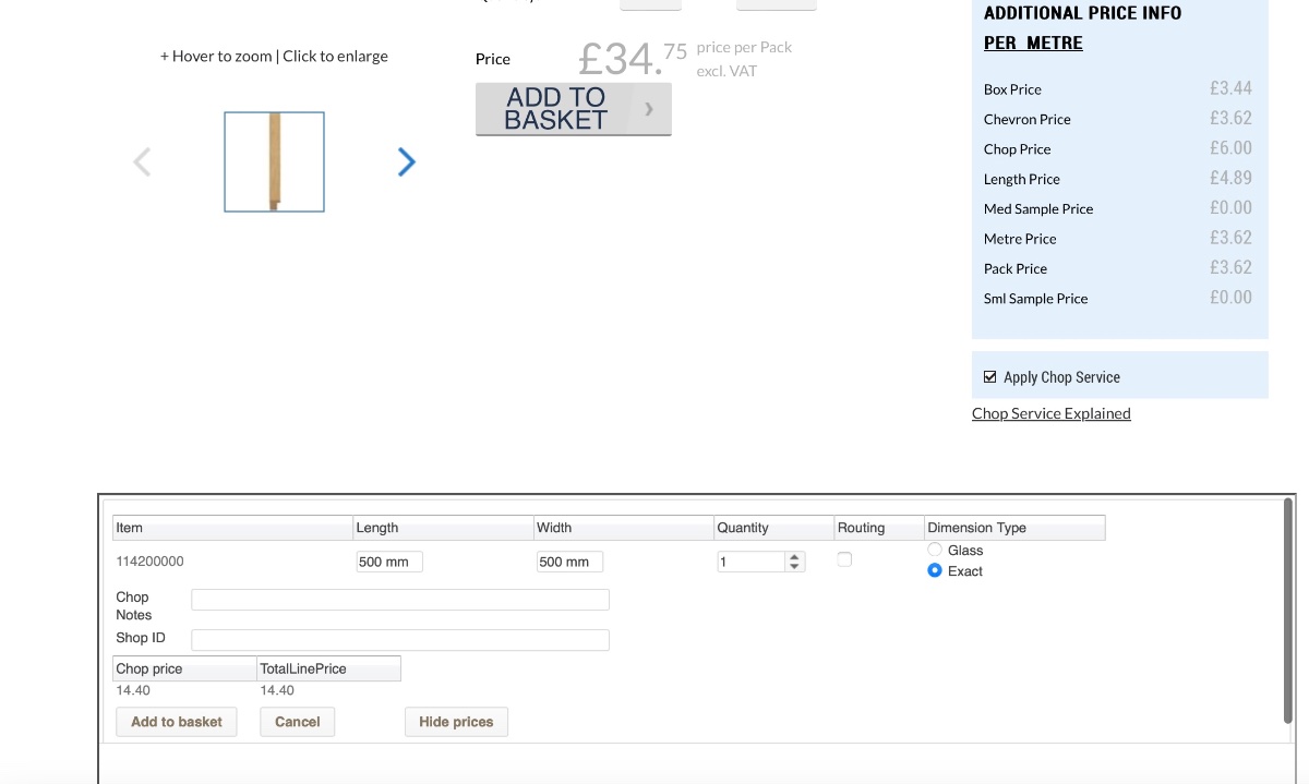

I noticed that Larson's chop price doesn't match with what they charge for chop (they add something else), so if FramR is using Larson's chop price, it'll never match.
As an example, this moulding is £6 per metre chop (which is the price FramR is using) but Larson's website calculates a 500x500 frame as £14.40 not £12. I questioned Larson about it a while ago and was told something like "chop costs more so we have to charge more". I get that, I just don't understand why they can't advertise the actual chop price. Surely That should show £7.20 chop price, not £6! And that's not them showing it inc VAT, the VAT is still added at checkout
