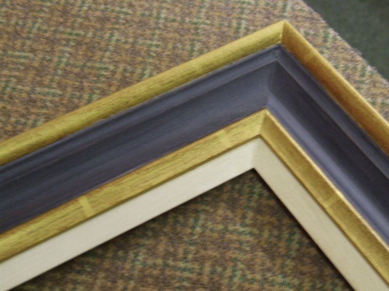

- Posts: 11685
Re: Gesso who?
This one has no gesso and no leaf gold on it.
It was done as I described. OK, it's totally phoney but all finishes are when you come down to it.
I prefer the term 'faux'.

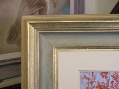

- Posts: 11685
Re: Gesso who?
So is this....
