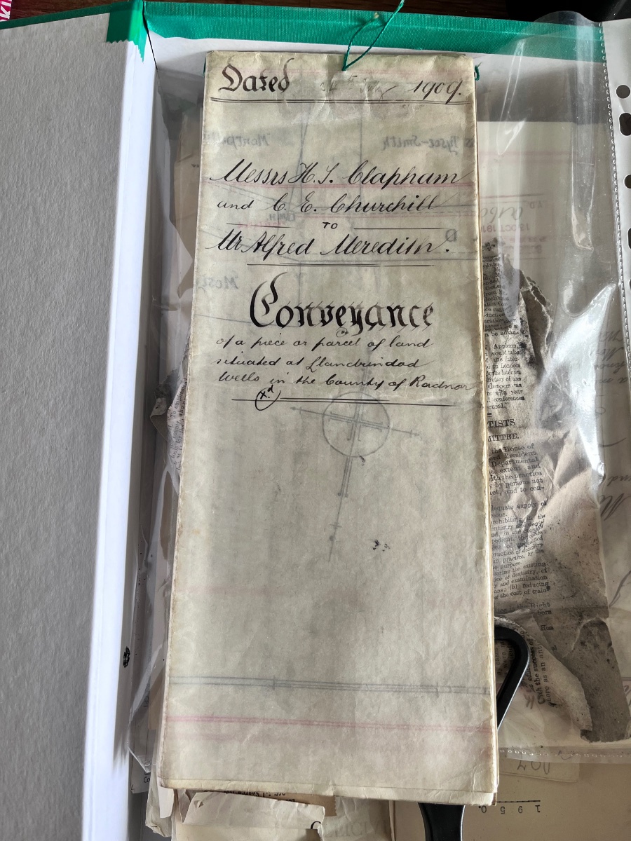

The customer yesterday was thinking of displaying theirs open and are going to come back for a chat. (It was closing time and I had to go).
My oldest deeds are folded up, But I would like to be able to take them out and look at the information on the inside occasionally.
This is my favourite, but the interesting information is on page 3 (while the road was being planned). It is a while before I will get round to doing anything, but I like to mull things over occasionally.
And this is one of the newspapers. We didn’t keep the mummified rat alongside it
