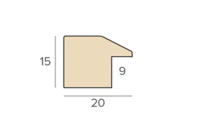

I am in the process of making up some tray frames with a canvas depth of 40mm
I can see canvas offsets are the component for attaching the canvas but as far as I can see they come with a depth of max 18mm
What could I use for 40mm depth?

I'm not sure that canvas offsets are what you need for a tray frame. How deep is your tray frame?
Usually the canvas sits in the tray frame below the top of the frame and is fixed with screws through the bottom of the frame.
Can you post an image of the moulding profile just to clarify?

Not sure how to post an image but it's this one https://www.lionpic.co.uk/p/43625/12mm- ... e-Moulding

That looks the perfect tray frame for a 40mm canvas.
1) check the canvas is square
2) make the frame so the aperture is 10mm bigger than the canvas
3) put the canvas into the frame and using off cuts of foam core or mountboard (cut into small squares) pack out the gap (should be 5mm all round, but canvas may not be square) with a couple of spacers each side.
4) when you are happy that the canvas is in the correct position, pull the frame towards you on the bench so you can access the underneath. Then drill a small pilot hole through the back of the frame, and screw from the back of the frame into the back of the canvas stretcher. I usually put 4 screws through like this from the back, and then check everything is in the right position before turning the whole frame over and inserting enough screws to hold it secure.

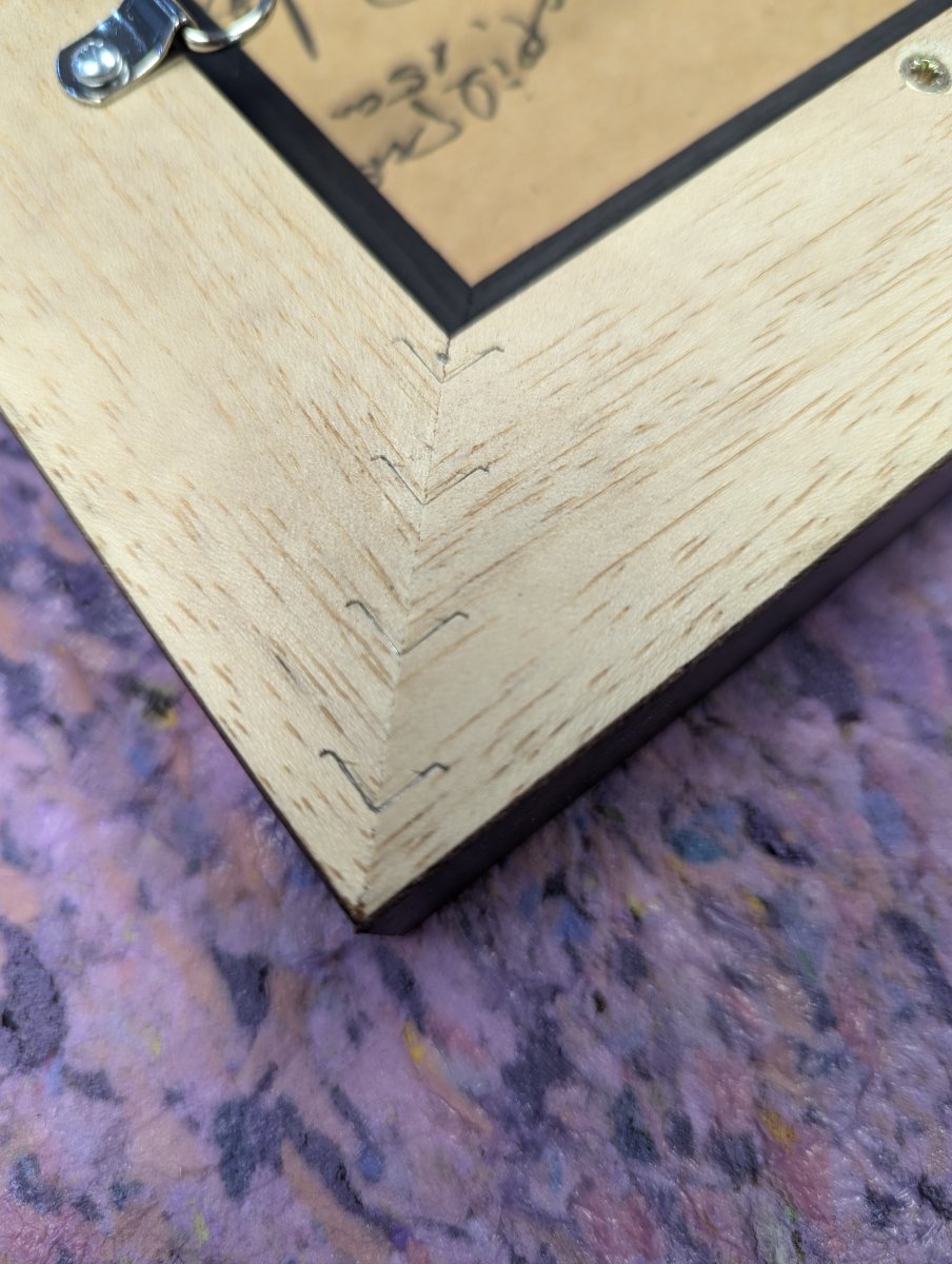

I'm just doing a test chevron on the L shaped moulding and I have a nice clean mitre so happy with that.
When underpinning on Casesse CS88 is it possible to fire a wedge into the tallest part of the L? At the outer corner?
On my test piece the mitre is clean but there is a small gap at the join with a couple of wedges in there.
I used a wood PVA but don't have a clamp so maybe that is why?
Do you guys glue and clamp? What is the process for ensuring no separation once pinned?

This is an L shape moulding, I glued and underpinned 3x 7mm wedges then on the outer edge 1x 15mm, you can double stack the 7mm wedges but I think there is less chance of the wedge wandering off if it is single. I didn't clamp

I clamp around 90% of my frames. With a yellow stanley band clamp, a tenner on Amazon.
Under enough pressure a good quality PVA glue is much stronger than a few wedges, so the clamp will ensure a good bond. On a float frame when underpinning, I'd clamp the top of the moulding as this is the face that you see, the wedges will hold the base together while it cures. As said, stacking wedges can be a precarious job, as they can often just fly out the side or just go in next to the first one. I'd never attempt to stack more than two.

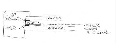

The artwork is 700x500 and the request is for edge-to-edge, similar to this reference
The moulding is
If the artwork is 700x500, what size should I mitre the moulding to?
What can I use to avoid the artwork touching the glass for this moulding shape?
Also, would this be T-hinged to the undermount?

I normally make the frame 2mm larger than I need to allow for expansion. This applies if I am using mountboard or not.
There are a few options for spacers to lift the glass off the print such as econospace plastic spacers, thin strips of mountboard, or wood.
If the print is the full size I wouldn't hinge to the undermount, the only time I would do that if the print is 'floating' and there is space around it.

If you frame a piece of paper like that it is likely to go wavy even if you do allow an expansion gap. The edges will be 'crimped'. On way is to add a 'slip' which will effectively widen the rebate and run a strip of linen tape along the back edge of the slip to raise it slightly. This will also space the glass away from the paper. It creates a small gap so the slip does not restrict the edges of the paper. I do this with large posters when drymounting is not desirable.
If that is confusing, here is a diagram....
Another way is to widen the actual rebate on the moulding but this is not alway feasible depending on the size/shape of the moulding and whether you have a router table. It's a bit of a faff.
