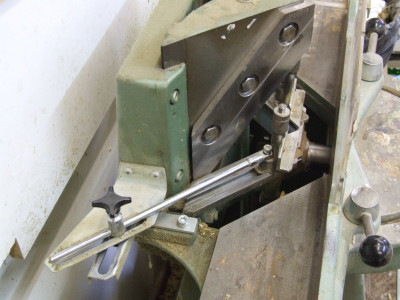

This gizmo helps with the issue of binding rebate supports.
- Posts: 1552
Re: I’m struggling right now.
Regarding the rebate supports.
Take them off and clean out the channels thoroughly with white spirit and 0000 wire wool. When dry, dust off any wire residue.
Now spray some PTFE, only onto the bases of the supports and let that dry.
They should now move quite freely.
As regards the blades - just replace them.

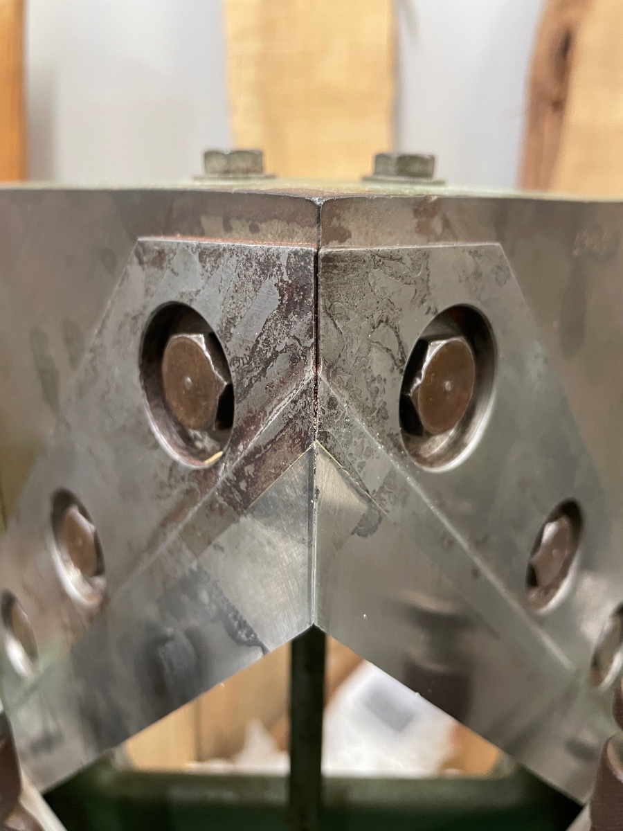

Here’s a photo of the blades. They were stored unused for years in a basement and a garage.
There’s a lot of what looks like staining on the blades that the white spirit, steel wool and scotch pads couldn’t shift.
Is it worth having them sharpened or just skip straight to a new pair?
- Posts: 2367
Tbh they look a bit fcuked. I wouldn't let them near a Morso.
Buy yourself/your business a Christmas present! If that isn't exciting you're in the wrong game
- Posts: 1483
If you only have one pair anyway definitely worth getting a new pair. Normally while framing you would put the new set on the morso, and then send the old pair off for sharpening which takes a few weeks, that way you aren't without blades for that length of time.sy_woodworking wrote: Tue 24 Dec, 2024 7:46 pm Here’s a photo of the blades. They were stored unused for years in a basement and a garage.
Once you have your new pair you will be able to decide if you think the old ones are worth sharpening.
