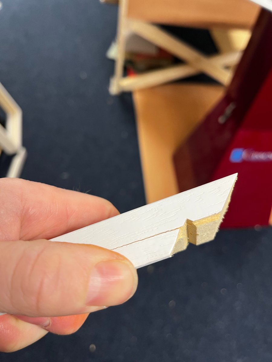

I'm recently new to framing. Bought a 2nd hand Morso F and I had the blades sharpened before using. I have used it quite a bit up to this point so my first question might be easily answered!
1. Picture 1 - I'm having jagged cuts on my mouldings in the last few days, does this look like blades need to be changed?
2. Picture 3 - I occasionally split the moulding like so. I raise my rebate supports so that they're touching the lip so I'm not quite sure what I'm doing wrong....possibly trying to take too many small bites off the moulding, starting with just the lip...maybe I need to ensure that the first cut takes in the whole lip and more??

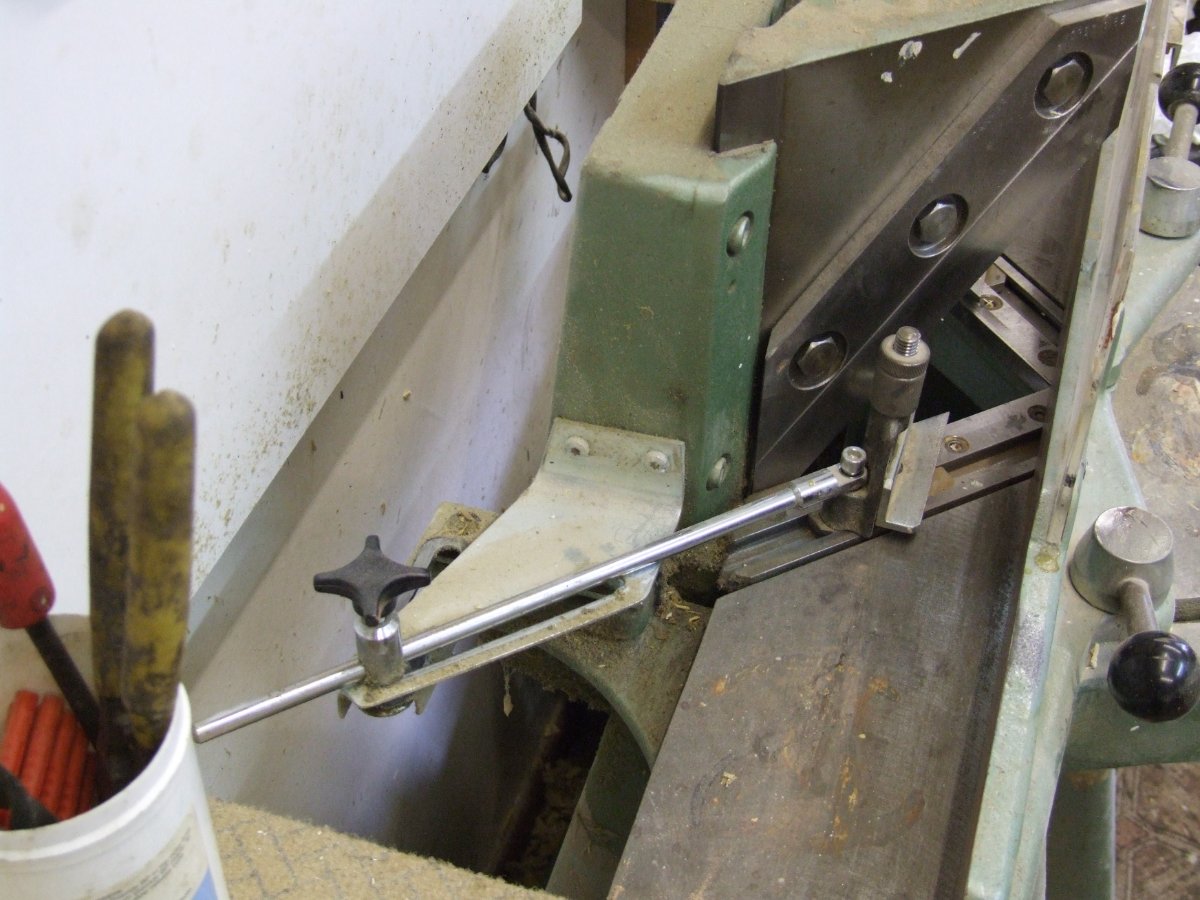

3. The Morso that I have (pic attached), what are the benefits of the newer versions? i.e. if I wanted to become a serious framer(!!), would there be good reason to upgrade? I did a framing course last April and on it, I remember the rebate supports being more user friendly.

Can I ask first what you mean by "the rebate supports being more user friendly"?
Looking at the photo of your Morso, I suspect that it would benefit from a clean down. Some fine wet n dry, alcohol, ptfe lube spray after.

I suspect you have one of the cheaper mouldings that can be prone to splits in the rebate. Having your supports in the correct place can help, but even then some soft mouldings can do this.

Thanks Justintime! Yeah I thought it might be difficult to diagnose!
Regarding user friendly supports, the new morso we we were using on the course had some mechanism to determine what height they should be - don’t ask what that was called, I just remember it being more straightforward!

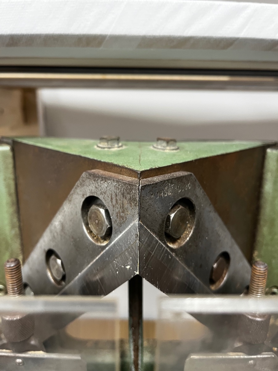

Can you take a close-up in focus photo of the front of the blades where they meet in the middle?

Ok interesting…could be very old blades alright…this pic ok? Thank you! 🙏🏻

I would echo Justin.
That Morso is filthy! I would spend a couple of hours cleaning that down, particularly the grooves that the rebate supports run in, and the rebate supports themselves.
I would then bite the bullet and buy a new set of blades. Those look near to the end of their life.

I fitted this gadget many years ago and it makes life much easier. :ninja:
I had to drill and tap into the block but later Morsos have holes in to facilitate fitting this.

Zooming in I can see the chips in the blades, the flecks of moulding where it's dragged and where it's caught between the gap in the blades.
New blades required!
I'd recommend downloading a Morso manual and carefully stripping it back a bit, cleaning parts and refitting as you go. You'll get to know the inner workings of it, which will help in the future.

Anything to degrease it, not sure meths will do that. Some parts will require reoiling after, check manual. These blades are really finely honed. If there's nicks out of the blade they're not going to work as expected. Invest in a brand new shiny pair of blades, simples!
If you want an idea of what you're dealing with, have a look at the dates on the blades, it's stamped on in the format 08 86 (August 1986!!) or 02 20 in my case. You can also find out the new blade spec for width and by comparing yours to that measurement you can get an indication of how much they've been abused, I mean resharpened.. If you have a Lupe, have a look at them under it, you'll be amazed actually how bad your blades are! :lol: n.b. They should meet perfectly in the middle and the cutting edge should be flawless. I'll stop now..

1. Some moulding is just so soft that it cuts like this no matter how good your Morso is. You can usually tell by how heavy it is. If I get moulding like this I will either cut a big bit off and then try again, or put a small piece of backing board behind the moulding (adjusting the cut length slightly), or abandoning that length and using a different length.
2. Each time you put new moulding in you need to adjust the rebate supports so they are just under the moulding but not pushing it up. If there's an issue I normally cut less rather than more. From the picture it looks as though your supports weren't supporting the moulding at all, are you sure they were underneath the rebate?
