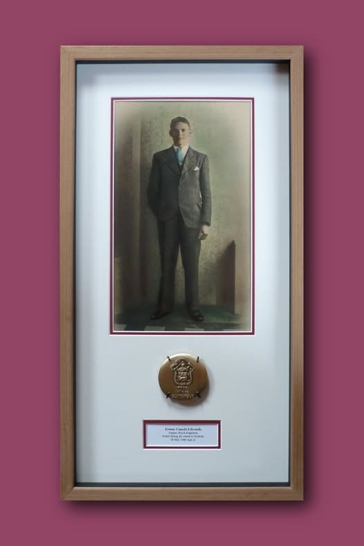

For something like this I have aluminium wire that is 3mm thick and bendable.
I feed it through holes in the mountboard behind the item and then bend it into shape to hold the item in place.

What Pramsay has shown is basically ‘formed rods’ which would be ideal. Piano wire is good just use whatever thickness suits.
I showed how they’re done here
viewtopic.php?t=9239
Photos would be good, back and front; if the back can be easily removed you could refit it over a strap of mellinex, cut to the full width (and.or depth, you could do it in both directions) of that back - that would certainly be strong enough and totally concealed.
