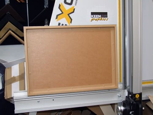

Just made this one today, SA tape is a bit of a pain but I use a burnisher to smooth out any small folds. Somedays the tape falls neatly into place and on others..... I guess licky tape will be easier to use.
