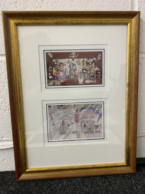

Parajanov - an attempt to complete more than one opening on a mount. Again, I tried varying the undermount from the top mount slightly, and I think this was less successful (the top mount being cream, the undermount being clear white with black core - two shades of off-white or cream would have been better). Aimed to keep a weighted mount on the bottom.

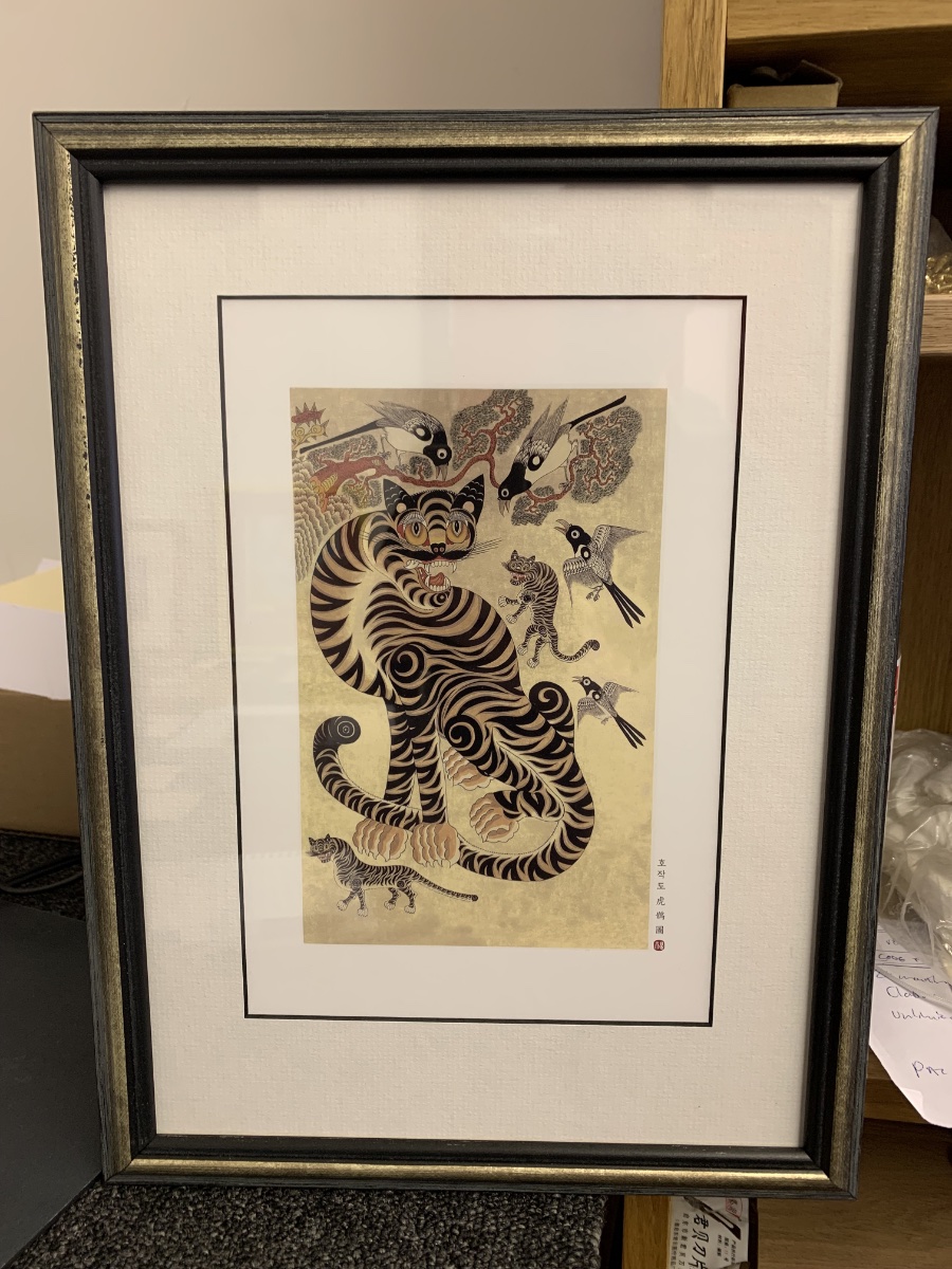

Korean folklore - used a black and silver moulding I already had for an image also predominantly black and white. The mount, being off white and textured with black core compliments the clear white image border, I think. But do you agree?

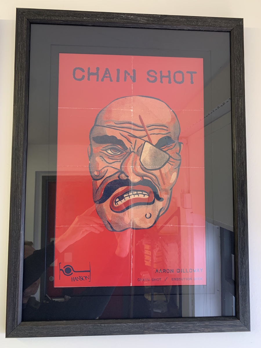

Chainshot - another image that I felt suited dark mounts and a dark frame.

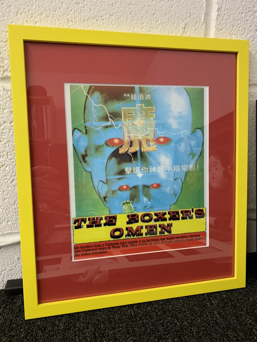

Boxer's Omen - in theme, not unlike one of the images I posted last time (strong colours, a frame designed to match the same colours). Okay, I don't love the end result of this, and the frame probably distracts too much from the image at hand. What do you think?

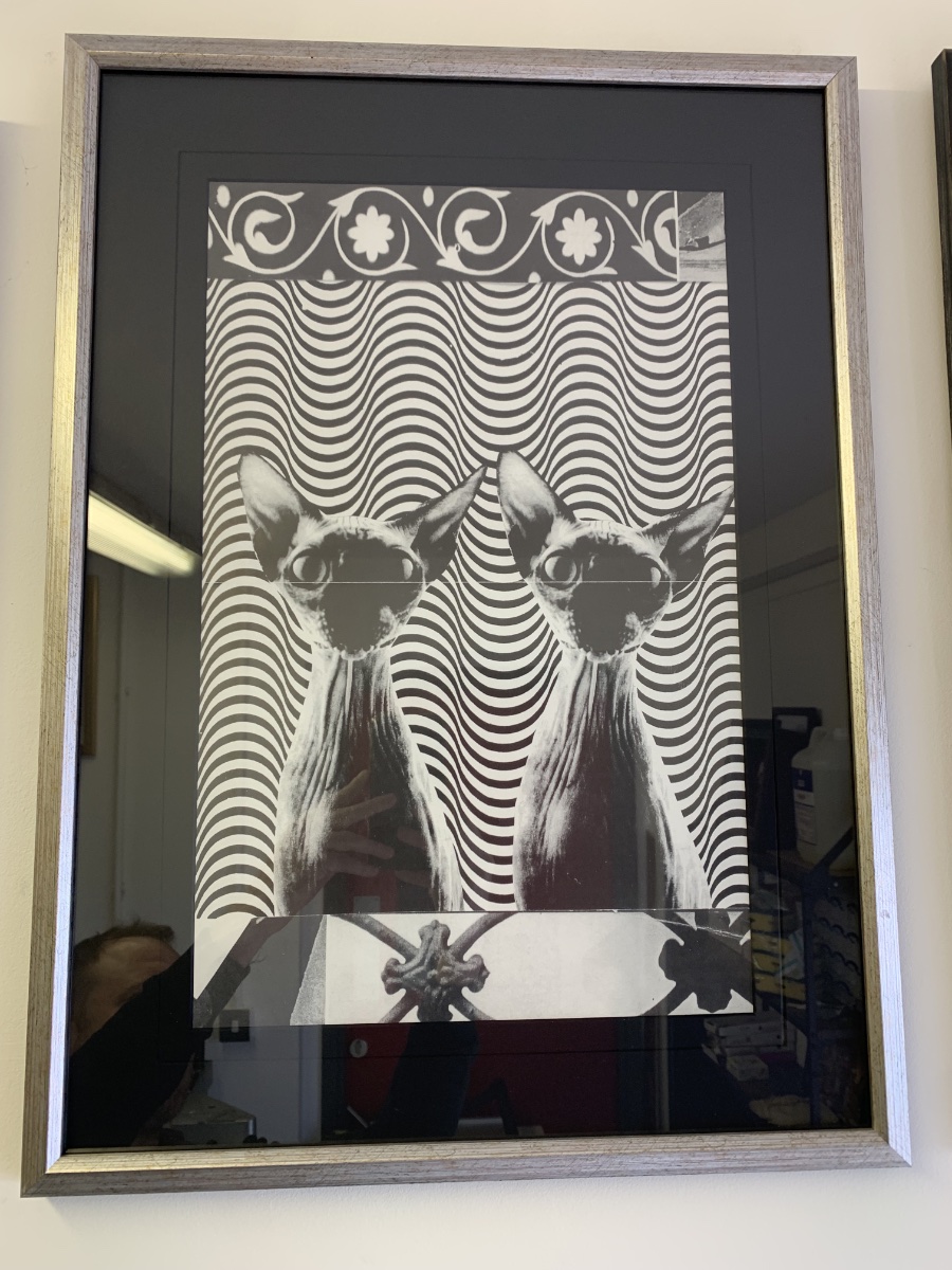

The picture with the two cats - is fine.

The Chain Shot is OK but would perhaps have more impact with a black scooped hollow type frame.
The picture with the tabby type cat of OK also. Maybe move the black mount line a bit closer to the image.
I will give no opinion on the Boxer's Omen.

I'm starting to see what you mean about scooped frames on Chainshot - it seems to make more sense when there's a lot black mat; the current one is just a bit nondescript.

Parajanov - With the double mounts, the space between top and bottom mounts feels too big and distracts. I'd have gone for a 4mm gap between mounts.

Chain Shot - Looks fine, yes I agree with Dermot the frame doesn't add a lot and could be more interesting.
Korean Folklore - Yes that works for me. It's a well chosen moulding for the subject matter. The mounts work too. I don't mind the uneven borders, it is a style of mounting used in Asia with long images like this.
Boxer's Omen - I can see how some customers might like this but it's too much for me. The major problem I have is with the borders of the print, they're uneven and it feels pinched. Visually I'd prefer top and bottom borders to match the side widths.

Double aperture job, too busy. Maybe swap inner and outer mount around - that would take the black core mount away from the artwork if it’s non-conservation, but you can get conservation black core mounts in Nielsen’s “Alphamat Artcare” range. Make inner reveal narrower. Double (triple etc) mounts generally look best going dark to light from the art out.

I think the last one is OTT - I think vibrant/leary artwork should stand alone. That would have looked better with the black mounted treatment given to the other things

As for Boxer's Omen, this garish scheme was already underway before I posted the other "loud" frame last time. It was actually a little challenge insofar as the print itself was pretty poor quality. One issue was the title box juts out of the rest of the image, but then the red box at the bottom, with the Spanish text was a lot deeper so I made the decision to cut that off, but one outcome of all this was that the white border was compromised.
