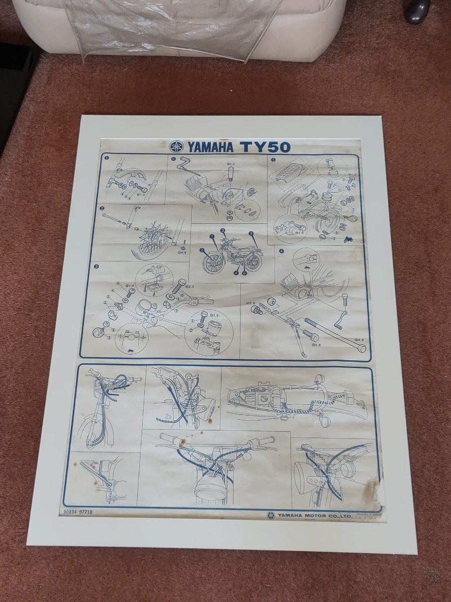

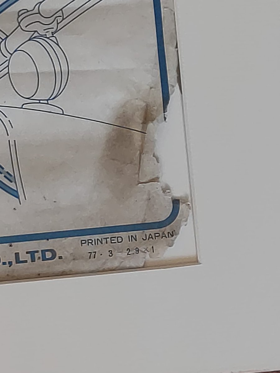

Hi all,
looking for help framing something that is a bit battered.
My cousin gave me some Yamaha motorbike assembly instructions that are quite crumbled and missing a corner.
I have gone for an overmount but was wondering if there is a better way.

I'd hedgehog it.

Float mount it on a bright and colourful mount to show off the imperfections.

Thanks. Do you mean space it away from the backing board with foamcore? What colour might you use?pramsay13 wrote: Wed 28 May, 2025 8:21 pm Float mount it on a bright and colourful mount to show off the imperfections.

To float mount something means to show the whole thing, raised above the mounting surface or not.
I’d mount it to navy blue mount board, and put much more space around it than you’re showing.

Thanks. How much space would you leave around the print?

Assuming that your cousin used to have one and that the finished piece is for them, I'd ask what colour theirs was.

I would hinge it on a mountboard that is a similar shade to the paper so the hole doesn't
'shout' so much. I did a similar thing with a watercolour of a Nun that had woodworm holes.
I spotted the mounting board with matching watercolour dabs behind the hole area.
It worked quite well.

At least 75mm
I’d also bottom weight it to compensate for the wider top border.
Colour is personal choice of course, but I’d ensure that choice is an informed one by showing options
I think contrast is good and a dark mounting surface will show the wear and tear nicely - if it’s an issue a perfect digitally repaired copy could be produced!
If it is to be a neutral colour, then I would suggest raising it from the mounting surface to create contrast with shadows.

My first suggestion would be surface mount using hedgehog method on something like Wessex WCM666 dark blue mountboard, I like showing the edges - its part of the story

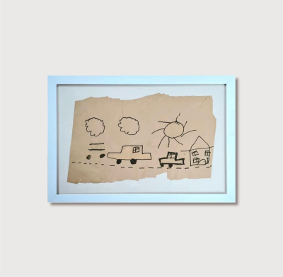

Here's an extreme example of a float mount used to show off the edges of the child's artwork.
I did another one that has frayed edges and even a hole in the middle but used a bright turquoise mount to highlight the imperfections.
For this one I would do the same but with a coloured mountboard, maybe blue to match the ink.
