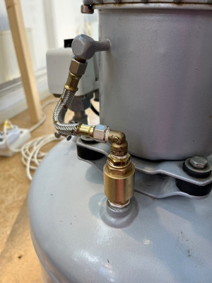

Is this a valve?
My sons opinion is that this is the thing that’s broken. In Swedish it’s called backventil.

Re: Compressor Jun-Air leaking
Framer in Göteborg, Sweden
Timh
- Posts: 374
- Location: mid wales
That might be it
Take it apart and see if there's a rubber gromit inside.
Worth looking
Worth looking

It was that not return valve (I’m learning a lot of new words) that was broken. Found a company specialised in air pressure and hydraulic just 15 minutes away. So now it’s been almost one hour without starting! Yay!
I’m so relieved! So happy and lucky that my son fixed it.
