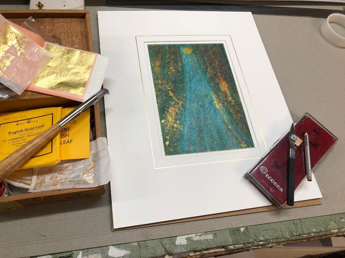

After finding an old thread on the Ecobra pen, I've bought one for applying specifically a gold line on mounts for monoprints. That will be framed in gold with an antique white mat (I've attached an image of the frame I want).
So far, I've seen you use dipping ink, not inside a fountain pen ink.
That you have to keep it very clean, for obvious reasons if you want smooth edges.
It's better to use a dropper = that really works well, a super tip.
So, what ink is best. My old calligraphy ink is thick and stodgy at the bottom, not rescuable. Before I buy a new one, is calligraphy ink a good choice for this pen.
I've bought an expensive stationery shop one yesterday, and love it - it gives a round line, but the line is too thick.
If I narrow the Ecobra points, the ink doesn't flow. Is there a knack?
Do I just add water to the ink? Or does the ink reject the water.
So far, I can do gold lines, which is a fabulous result, and I could stop there. But not fine lines, so they are very visible. Do you have any advice for me please.

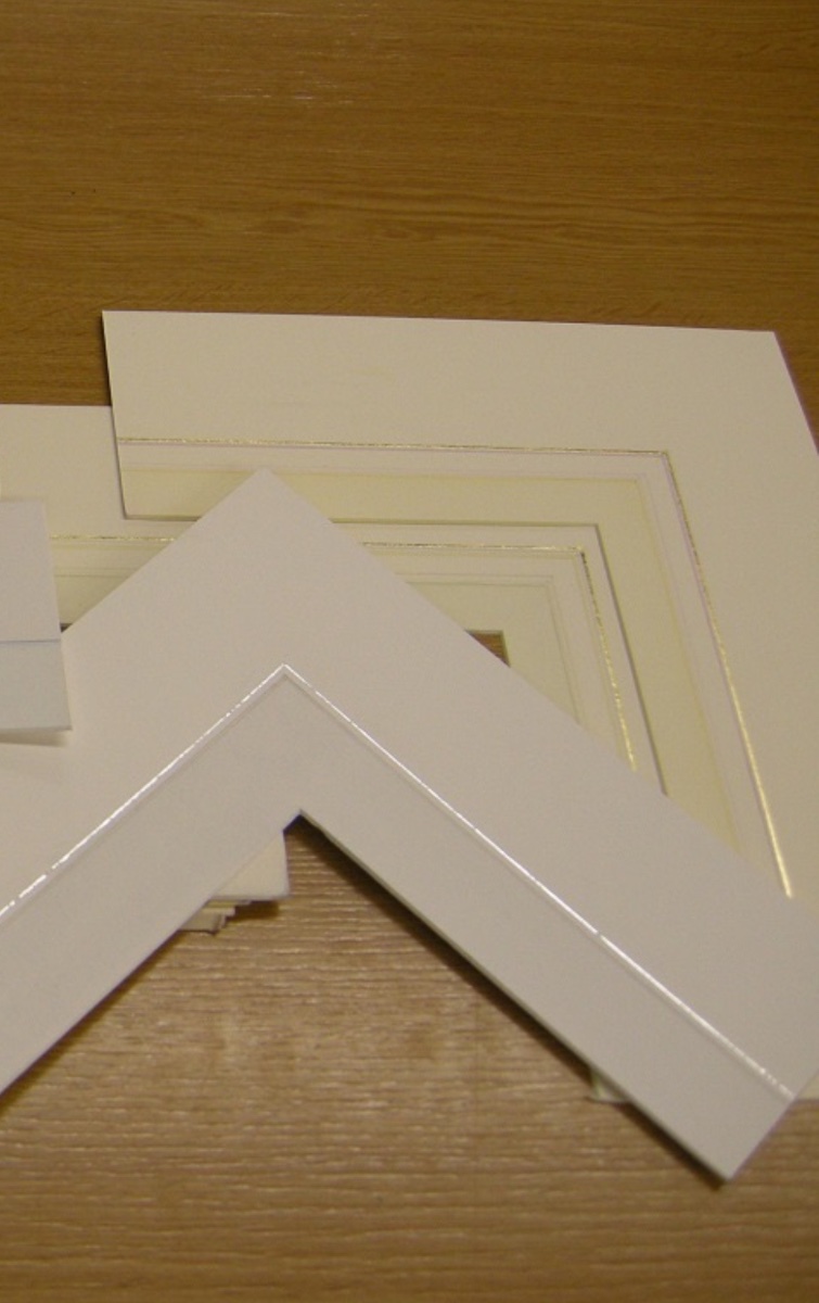

I never found a good gold ink or paint, there were probably some out there but I gave up. I used real gold or gold foil, for calligraphy and for mount decoration - I’d draw lines (or whatever) in a variety of adhesives, usually diluted, and with colour, red for gold, black for silver (or white gold).
Favourite sizes (adhesives) are acrylic gloss medium, various PVAs and wundasize. Some can be lightly burnished, others can’t as they dry too soft .
Shell gold (the little tablet in the circular pan in one of the photos below) is also very good, it’s pure gold powder bound in gum Arabic which you use just like watercolour. (But you strain the water through muslin when you’re done!) it can be burnished

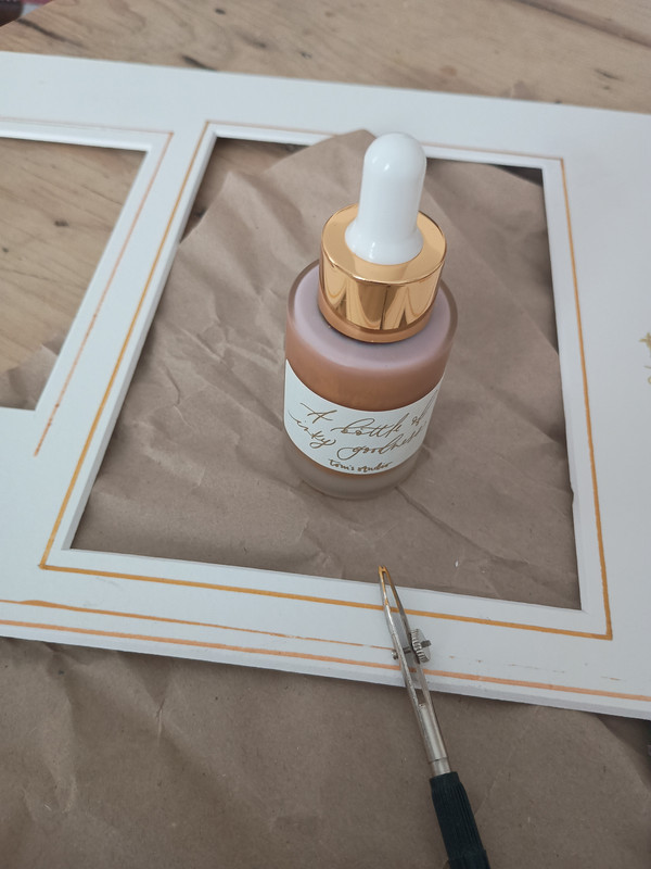

I load nibs with a brush and use a dropper, well, a pipette, for dilution.
All the gold lines here are real gold, even the silver one, it’s white gold.
