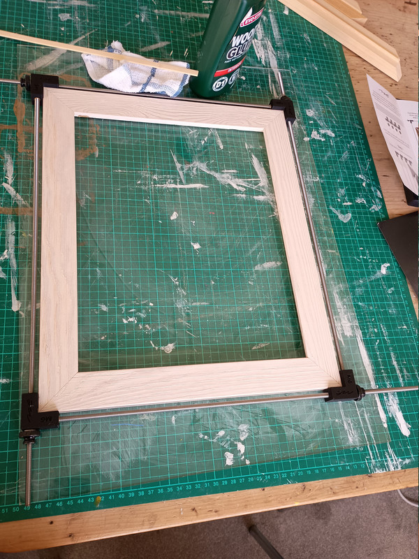

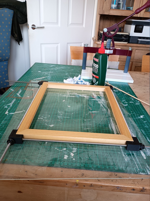

I'm not a framer, and have in general had struggles clamping the corners with a strap.
I make sure the front looks good and flat, but when the strap comes off, there is usually something that has drifted behind the corner block.
So I adopted the spring clips, which are great. I can disguise the pin hole pretty well afterwards, but at a certain point, the springs do lose their true shape. I should replace them, but it is my preferred clamp.
However, I've just bought another device which works extremely well. The Mattestlea frame clamp.
Mine goes up to 50cms. But was so easy, that I've bought 1meter threaded steel rods from Screwfix, as the corner blocks are a standard thread = M6. I see there is a 48" one online - https://www.ebay.co.uk/itm/404225222875 ... XjEALw_wcB
It definitely works, there is no twisting or movement if your bench is perfectly level, since the rods are solid.
If you can find 2m x 1.5m M6 rods, it should work. (You'd need a little bit more 210cms x 2, and 160cms x 2) if you can source them. Worth it if this a regular job. And at Mattestlea, you can buy the corners without the rods for £29 I think.
Works for me - but so far I've only done it 3 times on a smaller 500mm frame size.
And I don't have a studio any more, so gave away my underpinner, and use my Frameco, which takes the frame in the rod setup nicely. So you can underpin whilst the glue is wet.
All very manual, it wouldn't do for a business set up.
And cross threading, the stick in the woodglue tip is brilliant. Wipe the stick clean, and you're ready to go next time.
