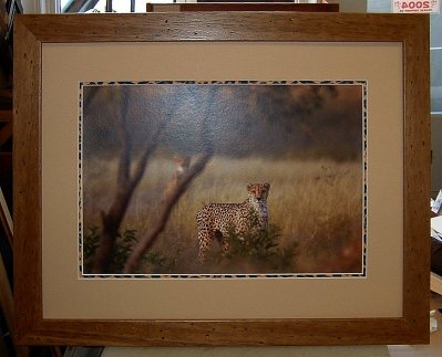

For those in the UK who may be interested "Falkiner Fine Papers", who are now known as "Shepherd's Bookbinding, used to sell paper backed silk with a leopard's skin printed pattern. It is dry mountable, I know because I've used it.
Re: Fabric Wrapped Mats
I've just had a quick look and I've still got the the picture of the inner mount covered with the leopard skin patterned paper backed silk. It was dry mounted to the mountboard and I had no problems doing so.
