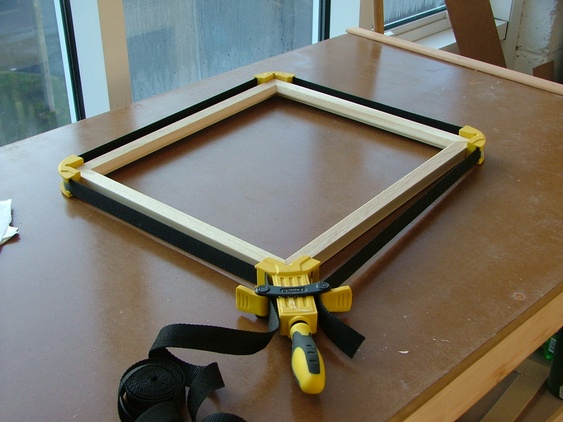

I prefer to ones that use webbing. Stanley used to do some neat little ones that you could cinch up with a spanner. On big frames I glue all four corners (with biscuits if necessary) and throw the band around. Tighten up gradually while jiggling the corners until perfect alignment. Then take it to the pinner. Some frames are too big for the pinner, in which case they get a couple of hefty woodscrews across the corners. But whatever method, as long as the clamp is in place the join does not get disturbed.
The Stanley clamps seem to be no longer available
, but the tie-downs you can get from Auto accessory shops are an alternetive.

I use the strap clamp all the time and makes joining bigger mouldings much easier. I use the stanley clamp which I can still get here in Ireland. On one occasion the strap was too short for the big frame so I joined two straps together with a small piece of timber and staples and it works fine.
I use carpenters glue(the yellow stuff). Just be sure to wipe excess as soon as possible with a wet cloth. Also if you put on too much glue it seems out all over the place. If you leave the strap clamp on too long any glue between the plastic corners andthe moulding can get hard and be impossible to remove.

It allows the glue to set up. If you move the L's around while the glue is still wet, it can strain the joint open as you move it and if the profile is such that a strap clamp won't work, it's difficult to get a tight joint.stcstc wrote:May i ask why you do the L' s one day then the other joints the next, i never thought of doing this and curious to what the gain is
On some profiles I use a piece of triangular plastic to protect the finish and many layers of masking tape, pulled tight, to pull the top of the joint tight. The tape only sticks to the underside of the moulding.
