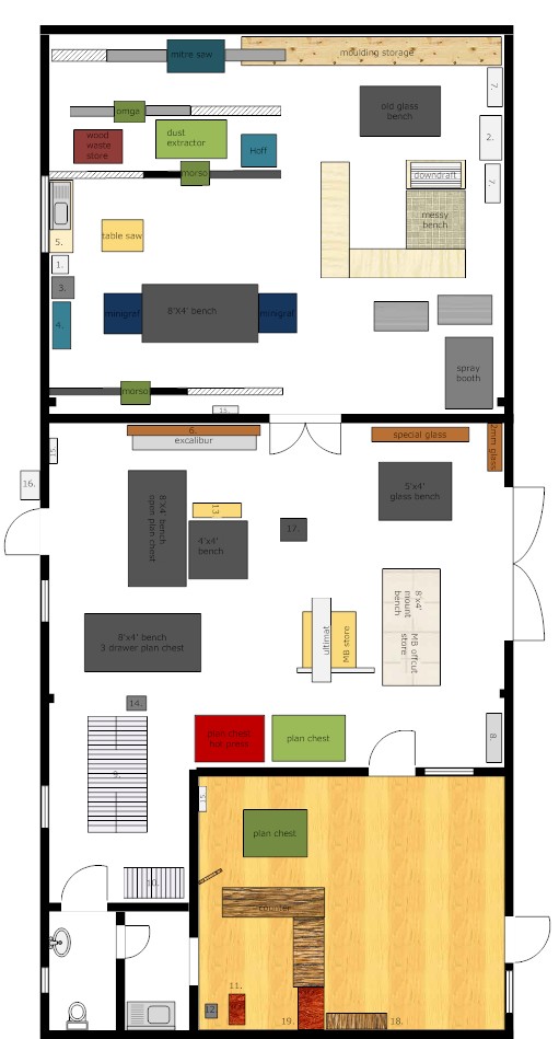

But now the store and the workshop needs renovation. We hired someone to do the sketch of the new store and workshop.
But because all of you are working many years you have the experience that I don't have in 2 years that I am working with frames ... I want to ask for any tricks on how to set the workshop
Eg. the working place must have 250cm * 90cm dimencion
The frames should places vertically and not at the ground.
I saw a video that a guy brushed the picture with a brush in order to avoid the dust or any pieces, or another one used air pistol.
And if you can do I need pictures because I can't translate all the equipment that we use
Any help would be very appreciated.

I recently planned a new layout using a drawing program. This was my rough plan, the dimensions and measurements are not that accurate, but it was very useful to help layout the machines and equipment.
I built a number of storage units for frames, paintings and finished jobs. Let me know if you would like some photos or designs for these.
I think that frame mouldings are best stored vertically, if you have the space. As for frames waiting to be used, you could use shelving brackets, or racking. These keep the frames away from the floor.
If you have a look at my blog you will see lots of photos from inside my workshop, and of various storage methods and so on, it may help you plan yours.

- workshop layout
- unit13layout.jpg (84.44 KiB) Viewed 5519 times
