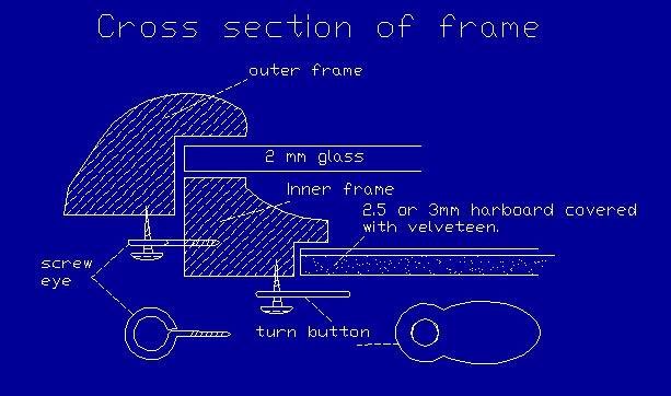

not sure if this is helpful - but what about using screw eyes - use these for our double frames but the inner frame could be a canvas frame ?
