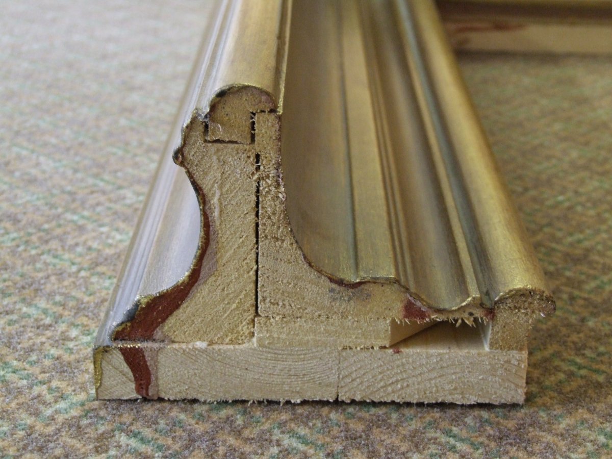

I was asked to replicate an olde frame the other week. Huge moulding - 5" wide and 4" deep. :o
Took a bit of head-scratching but I knocked up a sample.
The scooped back is formed using R&H A168 obeche with the back sliced off and turned on it's back. R&H A165 (trimmed down) forms the internal scoop. The bit that I cut off the back nice makes the shallow scooped section on the inside. This is all perched on 19mm pse pine and two bits of a hockeystick profile completes the job.
I was quite pleased with how it turned out. :D

Very impressive and like the finish too :clap: - Is it all just glued together?

You're a man after my own heart. I specialise in massive profiles, though not quite like that. If I had somewhere that I could use a table saw I would buy one tomorrow.
I wonder how many members of the forum realise just how much time goes into producing impressive profiles like this.
As usual a very nice job and something to inspire others.

The sample is a bit of a lash-up. There again, a lot of old gilt frames are very rough construction underneath the gesso. :P I'd do it a bit neater on a real frame. It's mostly no-more-nails and staples. :oops:
I was trying to get that nice tarnished antique look to the gold by painting it with dark brown acrylic paint and wiping off. Looks quite good actually. May have overcooked it in places......

I've just been looking at those two R&H mouldings in the catalogue. A very interesting bit of accurate cutting. Very nice work! I'm very impressed with the way you have done this! :clap: :clap: :clap:
I think I need to find a way of fitting in a table saw, as I'm missing out on some really useful potential by not having one.

I wouldn't call my cutting accurate exactly. :? I'm more from the 'fits where it touches' school of joinery. For this sort of work, a bandsaw is the better weapon. Finer blade and safer to operate. Cutting the inner moulding was tricky as I had to do it in two cuts from opposite sides. There is quite a bit of filler used. :oops:
I didn't twig that the bit cut off the outer moulding would form the small scoop on the inside until I cut it off.
