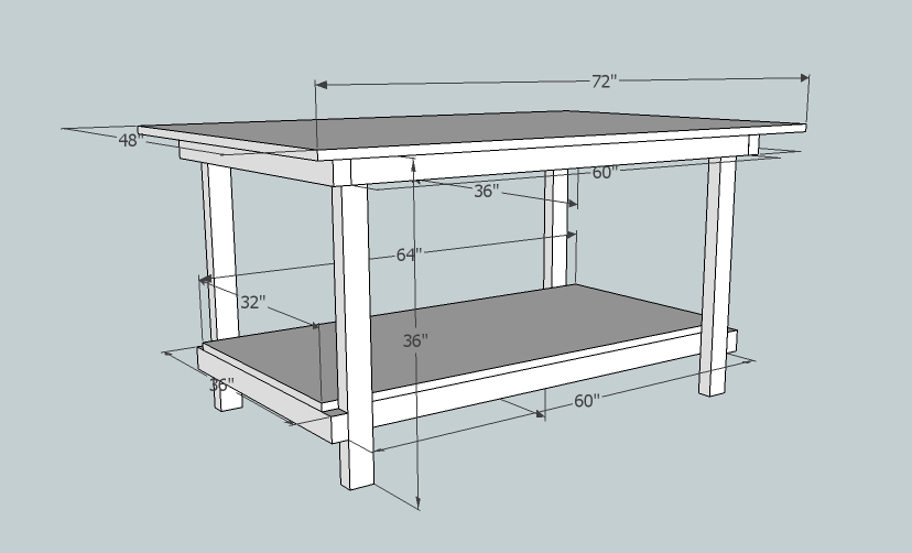

I have various models in skecthup, which I can send you
workbench 6x4.jpg (125.49 KiB) Viewed 5676 times

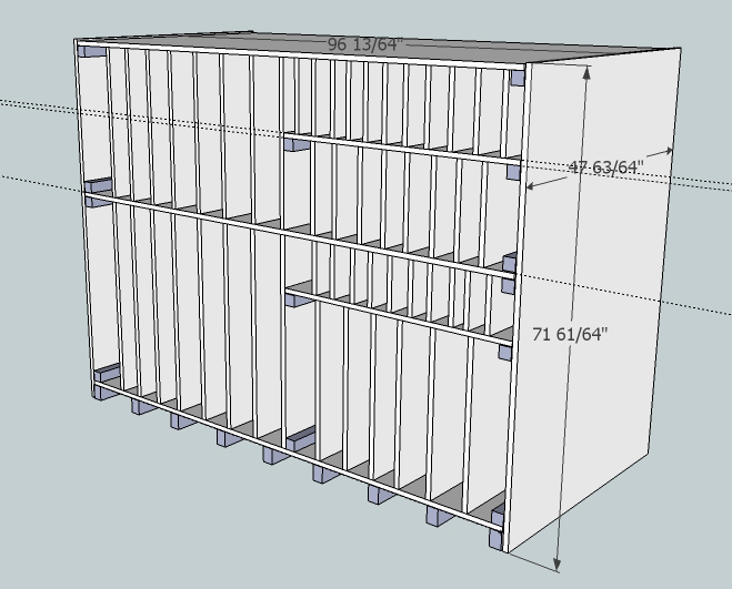

This is a storage rack/shelf type thing, could easily be modified:
I did have a plan chest design but can't find it at the moment...
picture rack.jpg (133.61 KiB) Viewed 5635 times

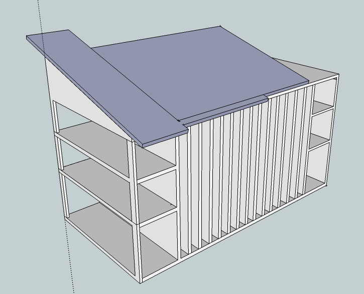

and a mount cutting bench:
Mounting table.jpg (138.51 KiB) Viewed 5634 times

Just one qusestion, did you use MDF or Ply?

Re: DIY Plan Chest and Workshop Photo's
Post by Steve N »
Framemaker, what's with the measurements 47 63/64" on the storage rack, about time you turned metric, :giggle: my first thought was you were in the USA. just kidding, I take it that it's the software you use, very nice design by the way.
When I plan any bench or storage system I try to use full sheets, or half or even quarter sheets of the material such as Ply, MDF or Chipboard, my benches are 8x4 feet and 4x 4feet.
Steve
framemaker
Post by framemaker »
Yep Steve, we are set in our ways, most paintings and frames are discussed in inches round here, and by our customers.
Google sketchup can be used in metric or imperial, I just prefer inches, but found sometimes you could easily create a dimension like 96" x 48" (8'x4') and other times my mouse movement would not stop on the dimension I wanted, and go a fraction either side! The designs were just useful to work out the layout and amount of materials needed.
I used MDF and some chipboard for my workshop units.
