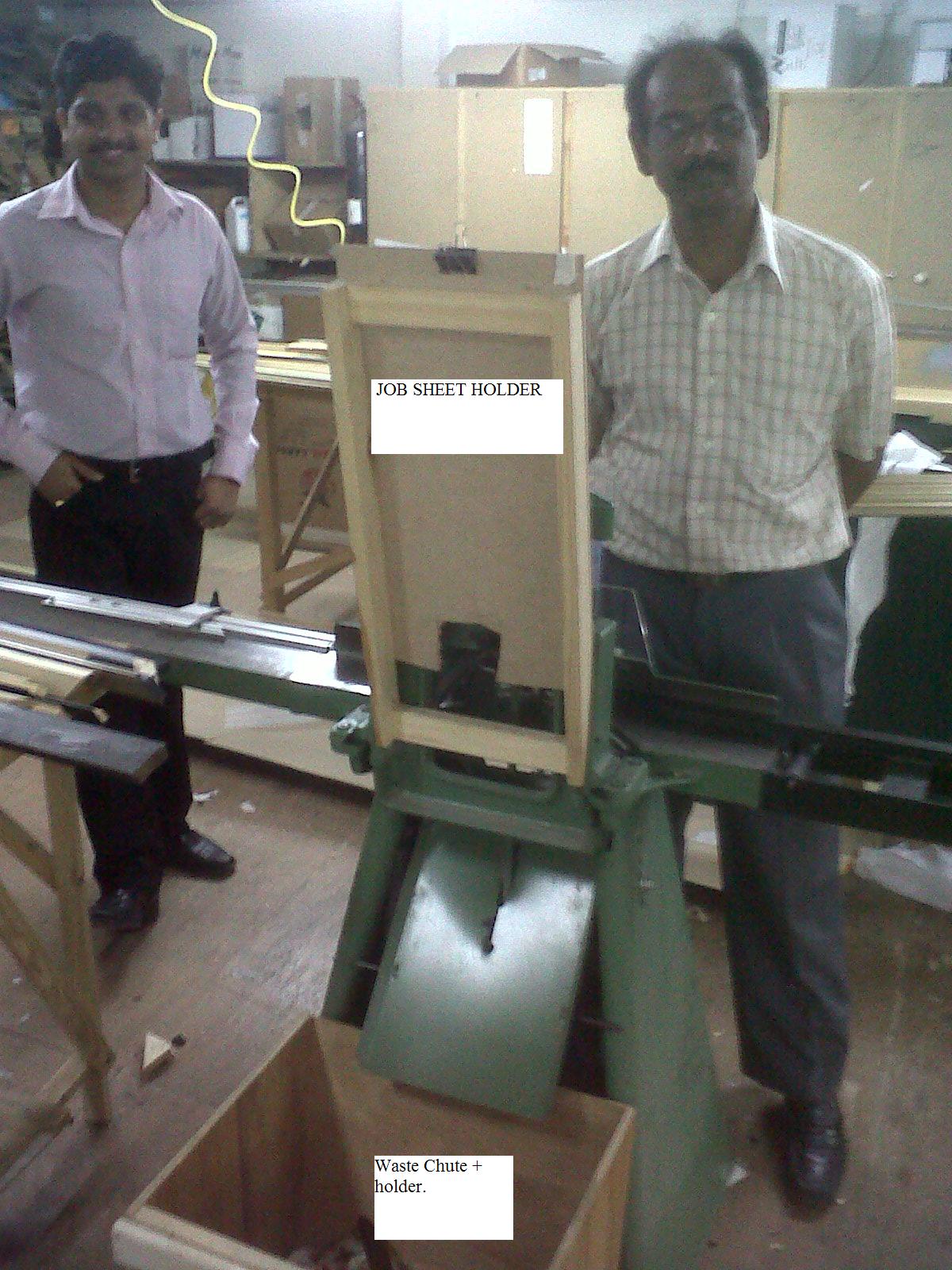

Nov. 2010 U.A.E. + Malaysia 173.JPG (298.39 KiB) Viewed 3130 times
Here is a pic of some innovative modifications made by Mr Basheer at Le Cadre, Dubai U.A.E. to all his Morsos. Danlist so liked the ideas they have decided to incorporate some.
