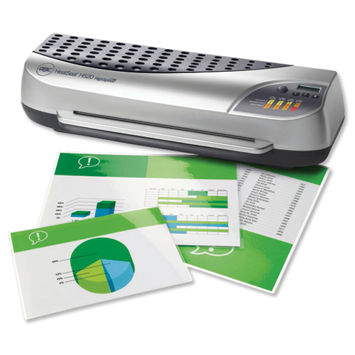

What about just a normal laminator? This type of thing.

Jonny2morsos
Posts: 2231
Location: Lincs
Location: Market Deeping
Re: laminating (sort of, I guess)
Post by Jonny2morsos »
You can get those stick on pockets way, way cheaper from online suppliers.
We got some a while back but I can't think of the company name right now. If interested PM me and I will find it for you. They only come in standard sizes though.
