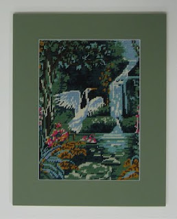

I do the same with tapestries and cross stitches. strips of foamboard around the edges a little larger than I know the mount borders are going to be then d/s tape on the foam strips, postion the mount and trim back like this.
Just thought a couple of pics would illustrate.
