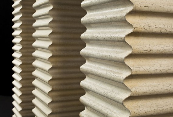

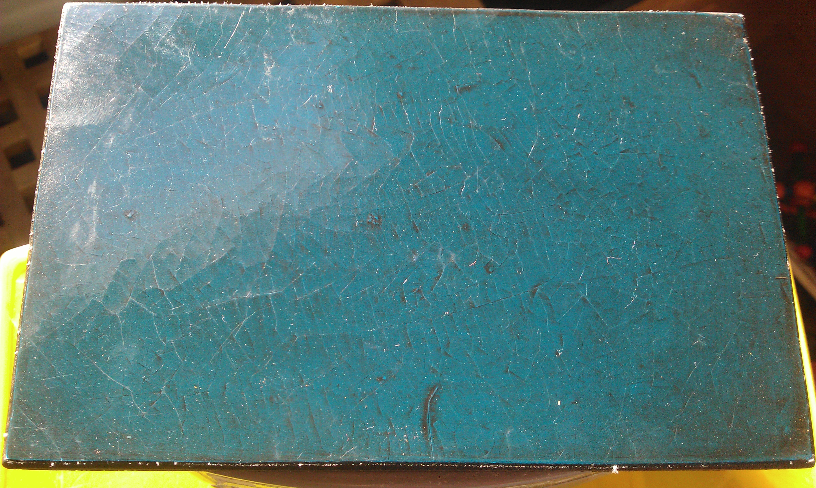

I'm a cabinetmaker based in Bristol and I am struggling to replicate a 'cracked' effect finish on some timber furniture. I am trying to match a sample sent to me by the client (see attached image: sample from client). At first I thought it was a craquelure lacquer, but after experimenting with different varnishes and not getting the results I wanted, I did a bit of searching on the web and found this image entitled 'cracked gesso' nowi think it could be a 'cracked gesso' base layer with colour wash over the top (see image 'cracked gesso')
I have been experimenting using 'uncle bob's crackle gesso recipe' I found http://www.thepaginator.com/Uploadfile/ ... 249-19.swf
but haven't had the effect I want yet - much smaller antique looking cracks.

In an ideal world I'd like to apply the finish/gesso directly onto finished furniture panels and mouldings and then have it crack afterwards. Is this even possible?!? See image below of a console which must be cracked on the furniture - I can't believe they can apply this to the curves afterwards.

Here's a better image of the sample I'm trying to reproduce...

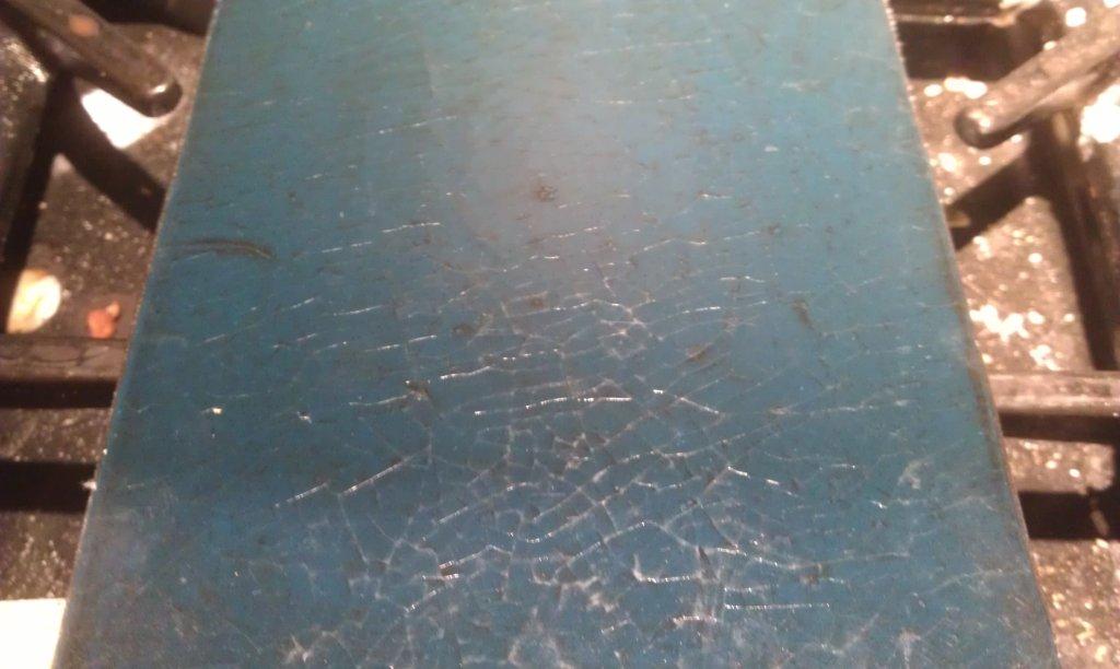

Yeah, I've tried the different drying varnishes technique. You get cracks, but more like separations/gaps - a bit like broken artic ice moving apart. What I'm after is a cracked look but very small or no gaps. Tough one eh!

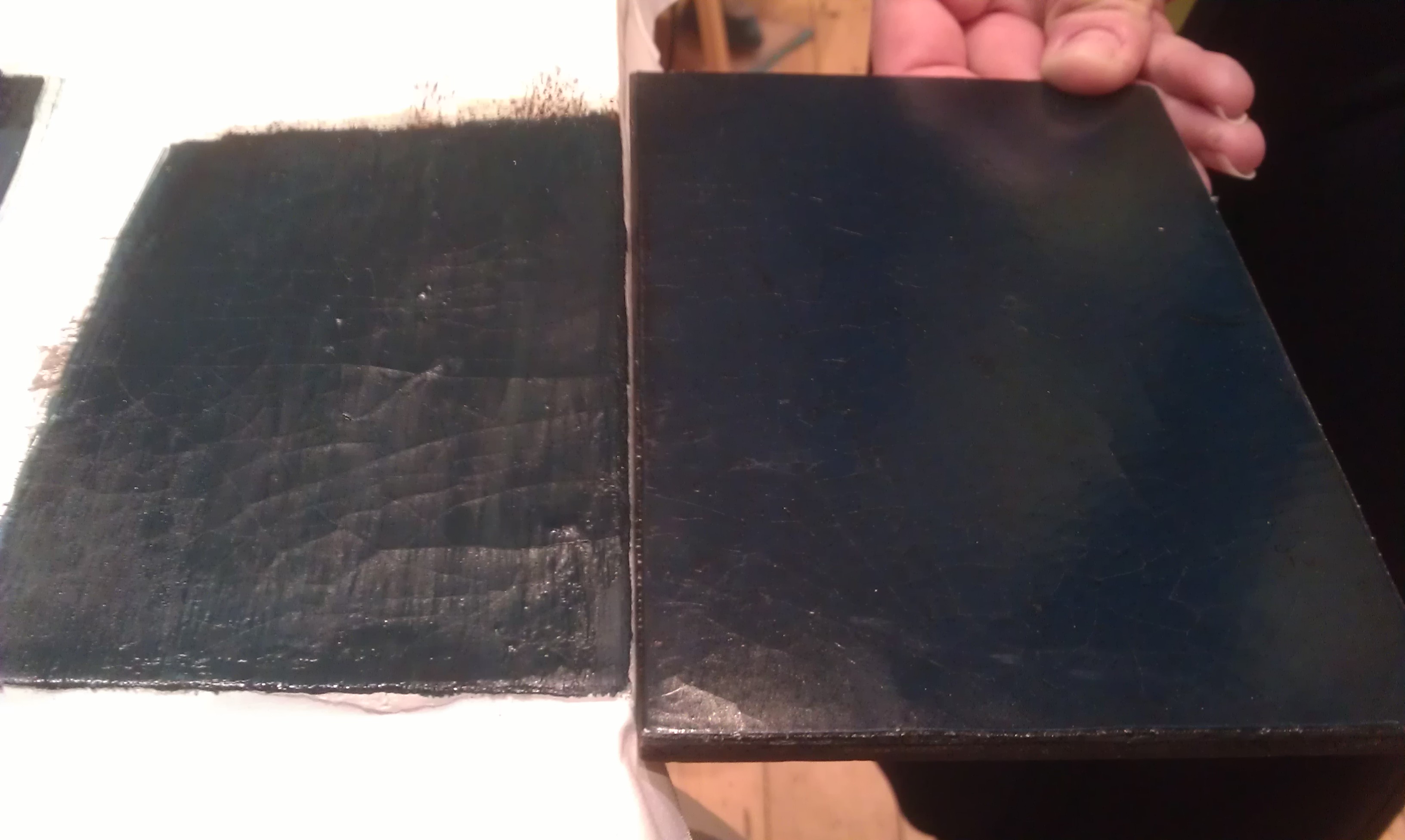

Cracked it!
Gesso onto material, let it go hard, crack it! Colour over the top.
