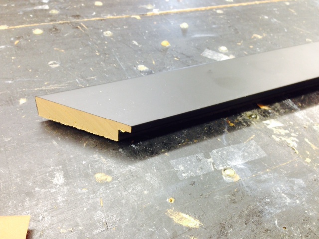

Looks great John, I've used a white version of that moulding, it's lovely to cut.
Can you talk me through the setup with spacers and black moulding on its side, I don't quite get it?

Re: Cosy

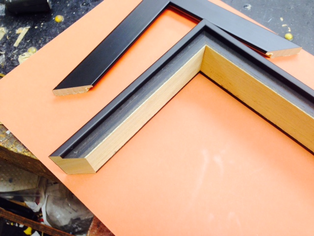

Here's a flat black moulding mitred normally
Here it is mitred on its side .......
to make a box

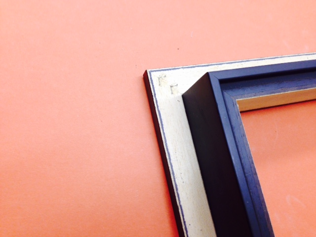

You can either put your frame in it like this (and Like I have in the first post).
Or you can put the box in your frame rebate and it will give you another rebate for your backings. But with this method you'll need a mount or something to conceal the box and I don't like the look of mounts on most 3-d things; I also don't like the look of a box poking out of the back of the frame (The "Cuckoo clock" effect!)
Foam board spacers are just like wooden spacers you can buy but there is no need to join them, just glue them to the rebate.

If it's to go inside the frame, yes and so could a pine batten from B&Q, but the advantage of using a flat moulding is that it gives a rebate for either the capping frame to sit in or for backing boards.
You can also use interesting combinations
