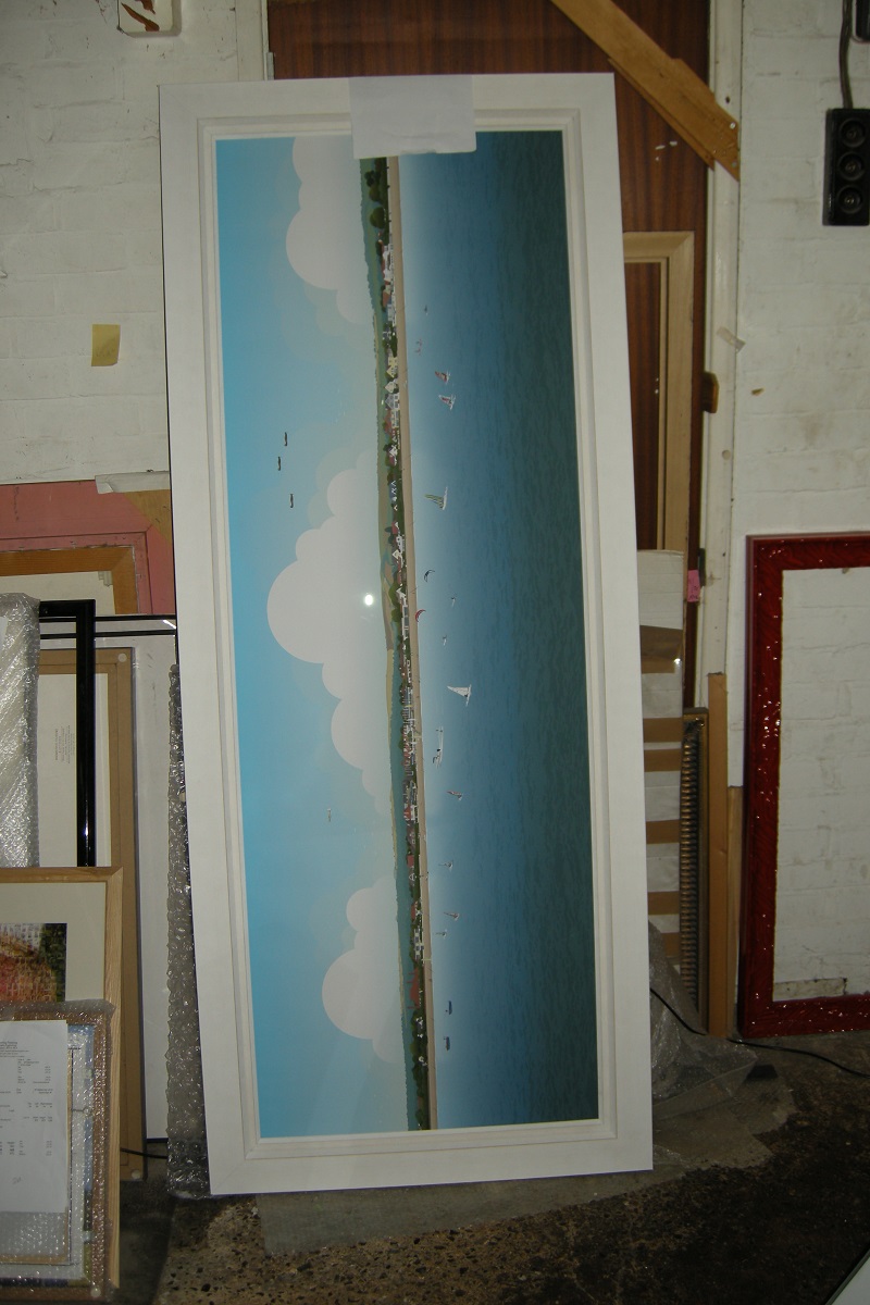

I like to use a double frame so the inner has a rebate, this one was 1740x605 (glass size) and it's the second one I've done.
The mounting/backing boards make the rebate flush and then a final backing board is fixed to the back of the inner frame, this takes out the pinching effect (which you could minimise anyway by putting no pressure on your tab gun when firing the points in) and gives pretty much the same effect as a platform mount.
