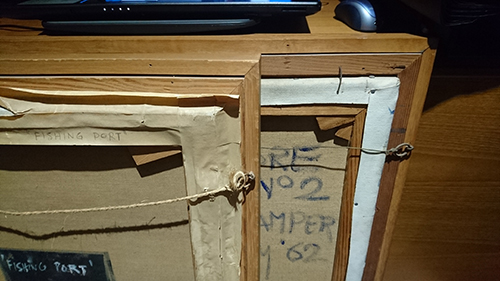

I have acquired 2 oil paintings that look as though the backs need some TLC. Please see attachment.
The canvases are held in place with nails and nailed to the frame. Should I leave these as they are or should I replace the nails with spring clips or canvas offsets? Would this devalue the paintings in any way? (Although the paintings have not been valued I'm led to believe that they would be valued at well over £1000 each).
One of the paintings has paper taped around the canvas whilst the other doesn't. The paper tape appears to be stronger than most brown tape (it's almost like webbing). Is it best to have a complete dust cover over the backs, just replace the tape or have no tape or dust cover? And if a dust cover was fitted what would be the best solution to make sure it is 'breathable'?
I would appreciate the expert knowledge of the experienced and knowledgeable framers on this forum.
Cliff
Cliff

I seemed to be common practice at one time to wack big nails into a frame to hold canvases. Not that there is
anything wrong if it works but it does look a bit half-arsed. Even worse if the nails are driven though the stretcher bars.
Getting a canvas out of a frame that has been nailed in can be tricky. On the whole there isn't a lot of merit in pulling
the nails out and re-doing it in a more enlightened way. The nails won't hurt the painting. If it ain't broke don't mend it.
As far as taping the backs, opinion is divided.
Personally I never do it. For one thing any dust is not going to hurt a good canvas. And with no tape on you can easily take
the painting off the wall and hoover out any detritus. If you tape it you can't see what's beneath. Who knows what creepy-crawlies
have set up home inside?
But the worse thing is acres of gooey tape sticking to the back of a canvas. You should be able to remove a canvas from a frame with ease.
Won't do any harm necessarily but it looks like carp.
** I should also mention that Z-clips are the work of the Devil.

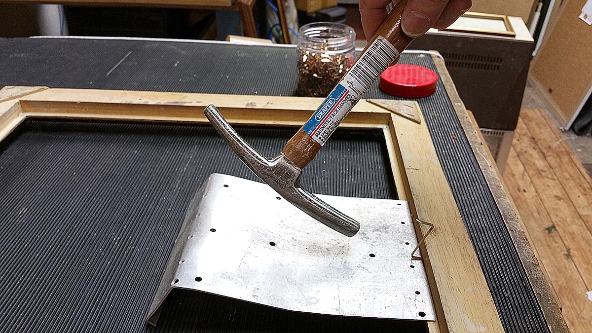

If you still have your heart set on using the Z clips, a shield such as this, made from a scrap of aluminium, will save you some grief.
- Z-Clip.jpg (252.83 KiB) Viewed 23309 times

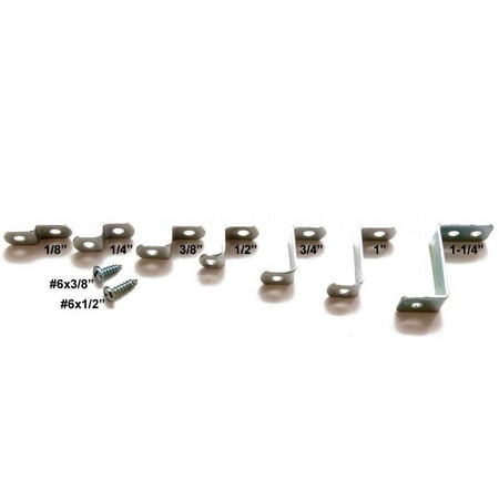

When fitting a stretched Canvas into a frame, one product we like to use are "Clip-Its", which I would assume that at least one UK supplier might have these. They don't do any damage to the canvas or the frame!
Otherwise, having off-sets of various heights on hand works just fine...
Best, John
Best, John

I haven't come across 'Clip-Its' in UK Framing catalogues or Google. Do they have any other name or identified by the manufacturer's name?
Cliff
Cliff
- John Ranes II, CPF, GCF
- Posts: 261
Re: Back of oil paintings
Cliff,baughen wrote:I haven't come across 'Clip-Its' in UK Framing catalogues or Google. Do they have any other name or identified by the manufacturer's name? Thanks Cliff
Here they are being sold on Amazon Online...
Listed as a Moore product???
As well as Dick Blick Art Supplies.
And even Michaels Stores....
Ahh, I see that Michael's has them listed with their full trade name, OOK® Canvas Frame Clips
John

Blimey, very mission impossible.JohnMcafee wrote:If you still have your heart set on using the Z clips, a shield such as this, made from a scrap of aluminium, will save you some grief.
I use a piece of waste mountboard...

The Clip-Its arrived a lot earlier than anticipated (Amazon predicted September - anywhere up to 14th). Unfortunately they don't fit - close but not close enough. And I'm not going to chance forcing them as I'm not going to risk damaging the paintings.
If they were the right size they look as though they would do a good, neat job. I also compared using them against some new stretchers. The stretchers need to be between 1.5 and 1.75 inches. I don't know whether they do them for other sizes but Amazon UK only do the one size as far as I can see.
