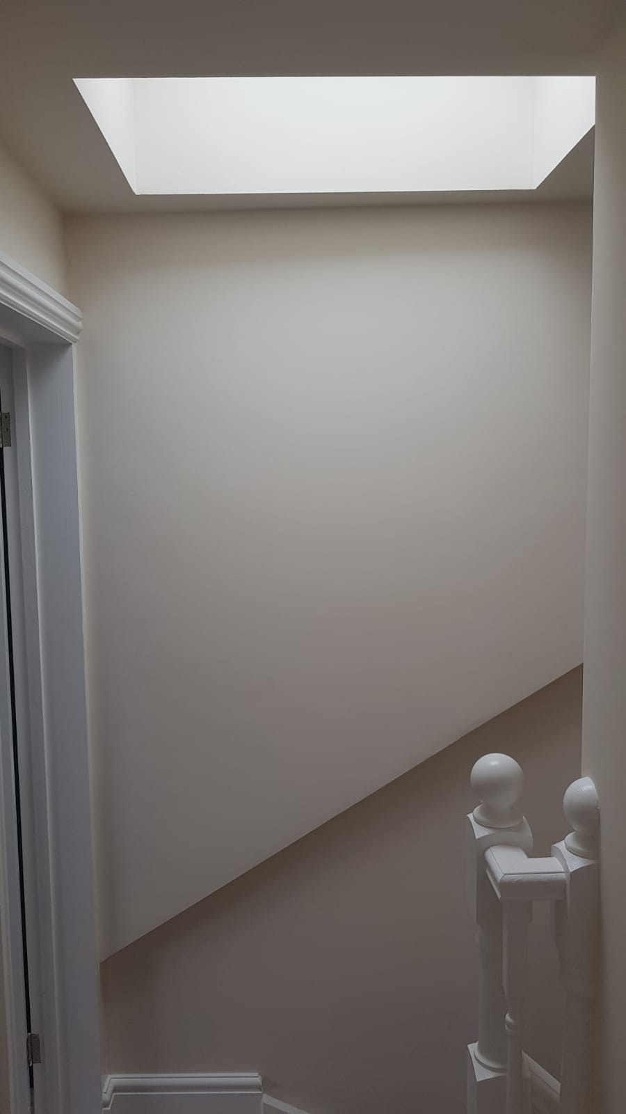

I am wondering if there is anyone out there with experience of making frames to fit funny spaces and where the angles are not going to be 90 degrees.
My friend wants me to make a mirror to fit the space at the top of her stairs (the back wall in the attached pic) the top two corners will be 90 degrees and the bottom corners will be ? degrees... basically the bottom of the frame needs to follow the diagonal line of the wall. However I don’t know how to go about measuring the angles needed and what tools I need for this.
I have a morso F which I believe I can adjust to cut angles other than 45 degrees although I’ve never tried it, and I’m using a cassesse 810 underpinner to join frames.
Any tips to get me started with this challenge would be much appreciated!

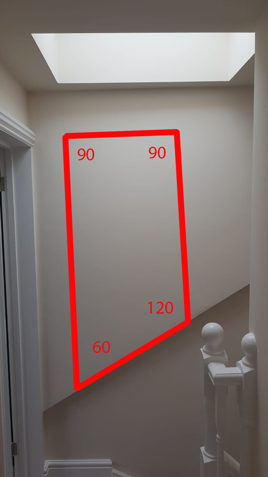

I had a mirror to frame exactly as yours a few years back. Looking at your photo I would guess at the angles to be 60 and 120 degrees. Obviously all your angles should equal 360. I used a clamp and when the glue had dried overnight I underpinned without any problems. The photo in this thread shows my frame but the angles aren't so obvious viewtopic.php?f=6&t=14766#p115605 see 9th post down. I cut the two odd angles by hand and then trimmed on a mitre trimmer. Plain wood and a hand finish would be a good choice so you can fill any gaps. A simple cheap plastic protractor is what you need to measure one of the odd angles then add to 180 and then subtract from 360 to get the forth angle.

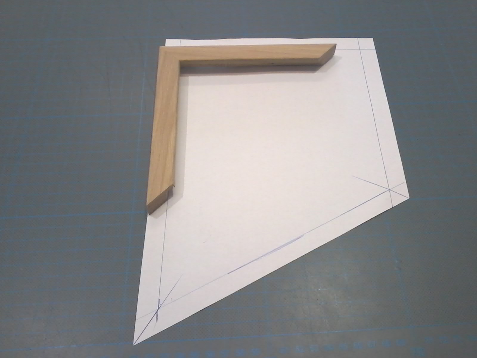

Cut template out of cardboard to the full size including the frame to fit the space, then with a piece of the moulding you are going to use, place this on you template lining up with the outer edge of card, mark the template on the inside of the moulding, so you draw a line all the way around the template , the width of the mounding in from the edge (does that make sense ?
At each corner draw a line from the outer edge of the corner to the inner lines, this will give you the angle of the mitres, you can cut a bit of card to the same angle and line up the saw blade on a manual cutter to this angle or a cross cut saw

I've done stuff like this before. I have tried just taking measurements and angles, but it very hard to it right like this. In the end, I ended up using a template and could have saved myself a lot of trouble, if I did so in the first place. BTW, it's easier with a large frame profile than a small one.
Forget band clamps for anything big, it did not work for me at all. I've assembled job like this on a flat surface and drilled and screwed the corners one at a time. It takes a lot longer than you think.
