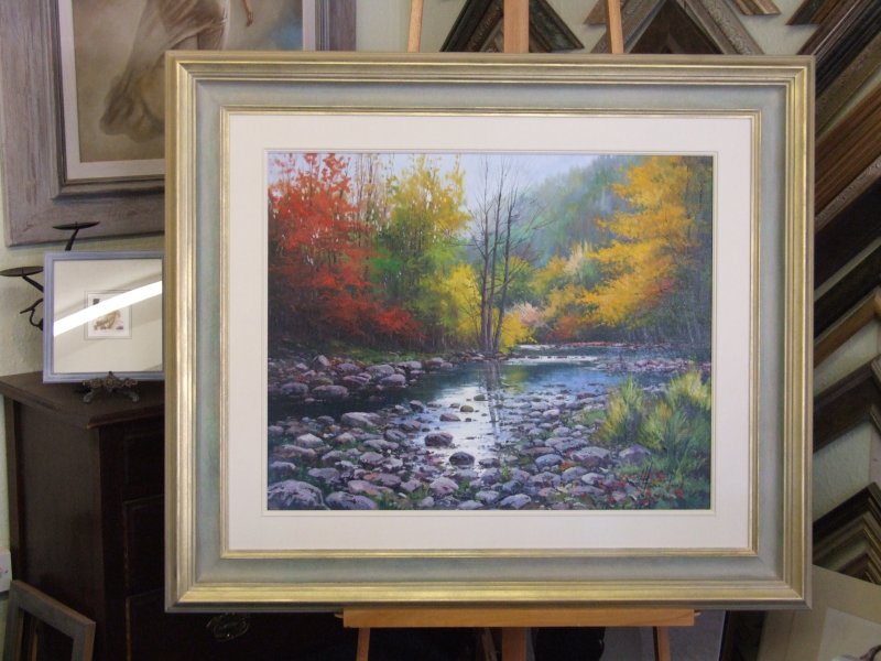

Re: Mountboard look but not behind glass
This is R&H A14 Obeche liner. About 70mm wide. Gives the 'mount' look. They also do two flat slips, one with a bevel
and the other a cove. About 7-8mm thick.
to a frame. So-called one would presume because it slips in between glass and art. A 'liner' is essentially the same thing but has a rebate.
I do a LOT of painted liners. Most are in the off-white category. A 50/50 mix of acrylic Titanium White/Titanium Buff gives my the tone I want.
Sometimes a toning wash of very dilute Raw Umber with a dab of white mixed in. Flood it on and wipe it off to give a very subtle mucky aged effect.
Unless you like the woodgrain pattern you need to fill the grain and apply several coats of thick ripple coat paint followed by a good sanding before
applying the top coats of acrylic. The ripple paint gives you the option of making a textured surface. It will hold brushmarks so you can stipple the
wet paint or apply with a palette knife for the 'rough plaster' effect. Can look very good if you don't overdo it.
R&H A286 is a bevelled liner about 50mm wide.
A231 is a flat slip with a bevel about 70mm.

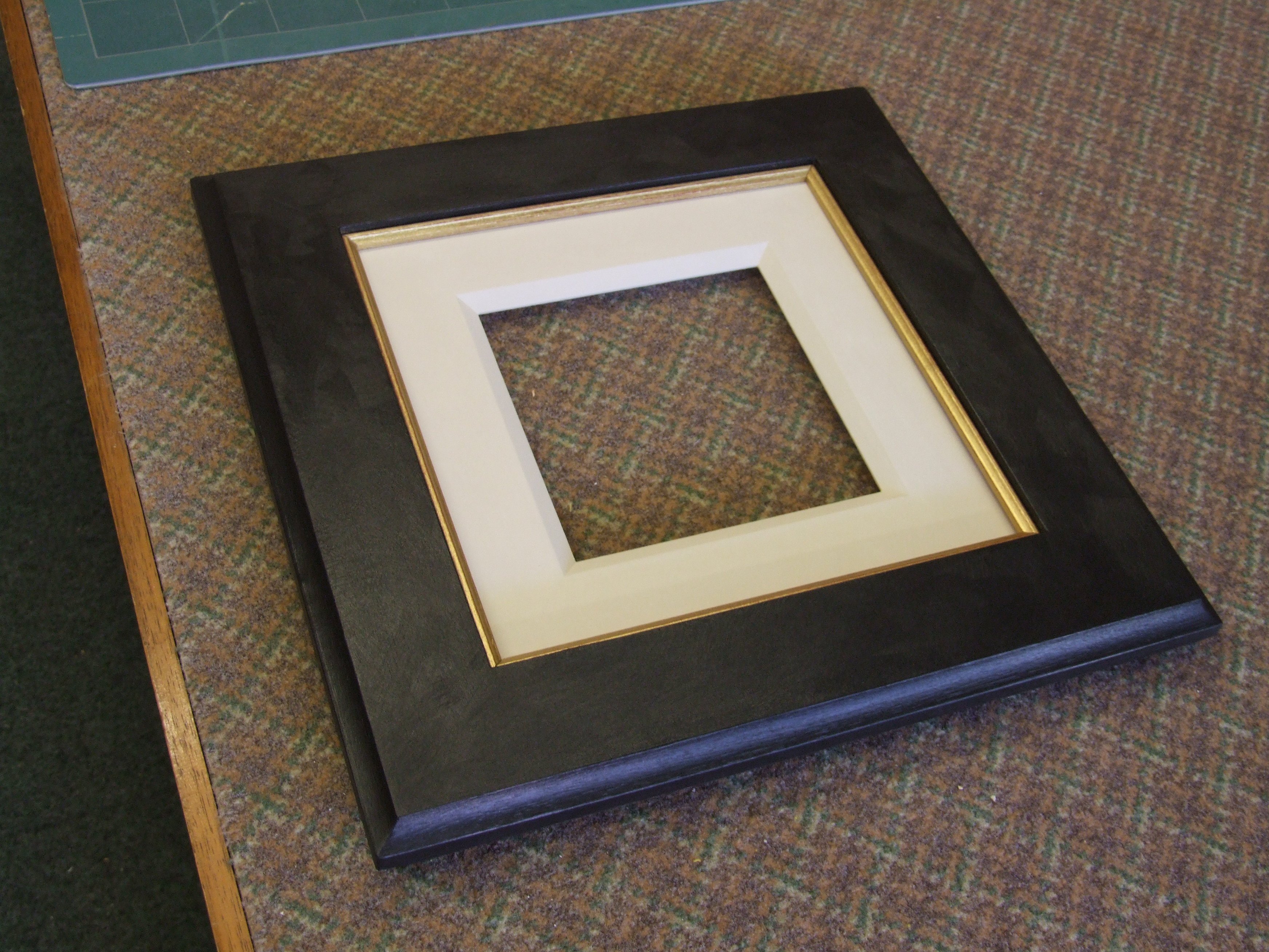

Part 2.....
There is a way to use card on liners. There is some board generally called 'grey board'. In the past it was used for backing board but it's terrible stuff
and sucks up moisture from the air like a sponge. It's basically just grey pulp. But it does have it's uses.... Because it is a solid lump and has no facing
papers it can be easily painted. Also easy to cut.
The inner 'mount' part of the above frame is made with Grey Board. There are two layers joined together which gives it a bit of body and stops
curling. It's painted for a faux leather effect but you could just as easily do it white/ivory. The board has a smooth side and a slightly bumpy side.
This frame has glass, but only in the oval window.
*** Thanks to the 'Old Master' Pete Bingham who devised the method.
