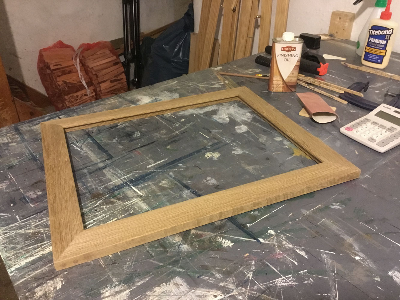

I used to use clear wax on all my oak frames but now much prefer an oil finish.Overlander Matt wrote:Do you normally finish the oak with oil?
I use Liberon finishing oil typically about 4 or 5 coats. So often I see, when out and about at art fairs, exhibitions etc., unfinished oak frames that to me look, well, unfinished! All my plain wood frames get a good sanding before finishing and then several coats of oil to build up a satin finish, the more coats the more sheen. You can't rush oiling an oak frame... you need a few hours between coats. It does change the look of the oak, more so than wax but to me that brings out the beauty of the wood
You can see how oil darkens oak on this frame with just one coat of oil. Subsequent coats won't darken it anymore but will add a sheen.
