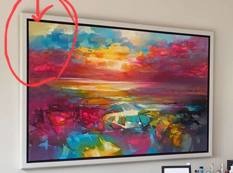

Anyone recognise this moulding ? Client is asking for same frame
Have checked centrado and lion but can’t see anything similar a prefinished choice . (I realise I can paint a bare frame)
Thanks again in advance

I would say that it's a barewood moulding that's had the rebate removed and a backing attached to create the tray frame, or if that's a step in at the back, then perhaps an obeche tray frame attached to a barewood moulding.

Sorry I should have put more info - it’s a tray frame and the inner edges are black

No I've never seen a tray frame this wide and shallow before, but could be created..

Its 2 mouldings,
Outer is 010-8408 https://mainlinemouldings.com/lothian-4 ... -moulding/
Inner is probably something like 017-4103 https://mainlinemouldings.com/l-shape-1 ... -moulding/
