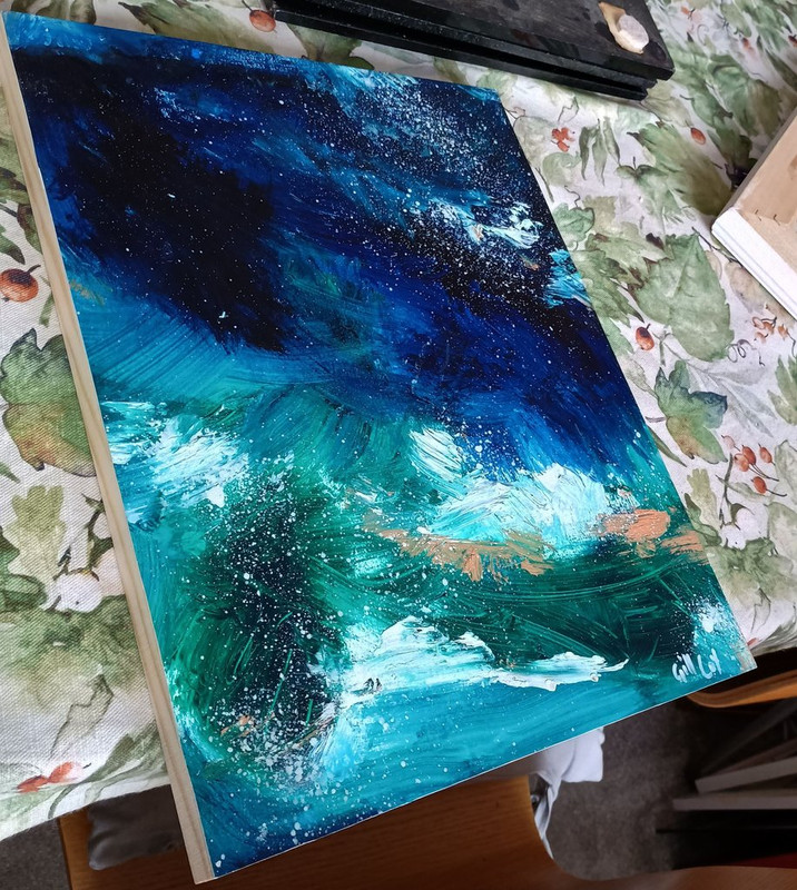

I have recently done this with 4 x oil on paper paintings.
Not sure about mdf, I never know if it is ph neutral or not, I buy birch trays that are gesso primed and totally smooth.
Apply pva glue to the paper, but not the wooden board. Lay it straight and remove any air with my hands, and then a silicon scraper.
And weigh it down overnight with a heavy board, checking for air blisters periodically.
When totally dry and totally flat, I then smear a very thick coating of cold wax over the picture, and knead it in with my fingers, leaving it to set and to create a protective layer. It can be buffed too.
(Like furniture wax, it protects the surface from knocks, marks and chips).
The result is excellent.
And my reason for doing this is I have trouble selling my very strong coloured paintings when they are behind glass.

Sure thing.
I haven't decided whether to frame this one St Ives, or a normal frame which will keep those edges away from the elements. 1 thing, I cannot stress enough to try this out on a piece of unimportant test paper first to get the hang of it.
My biggest fight with glueing canvas or paper to board is unexpected blisters.
With paper, within a few hours, you can prick them with a pin, and get it down again. This is obviously easier with oils and acrylics, as it's invisible from the front.
The primed beech panels cost £5 each 14" x 11". And with panels you do not get curling or bowing.
Cold wax is often on offer, I got a big tub from Jacksons for £15, and it's designed for oil on paper.

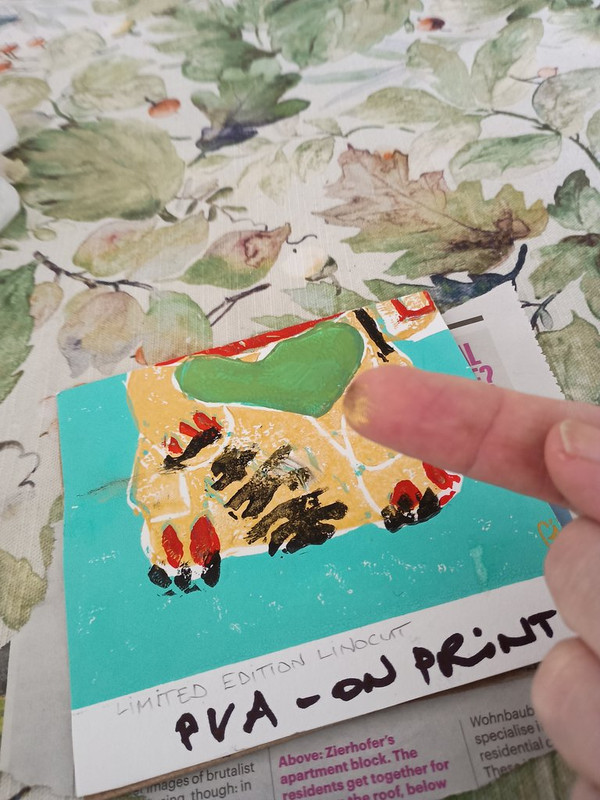

PVA glue on the back, I use artist quality, not children's hobby glue. I hope you can see the good seal, including those edges.
Anyway. It does work, with a bit of courage in the process (and that's easier when it's your own work and not a framer's client doing the asking).

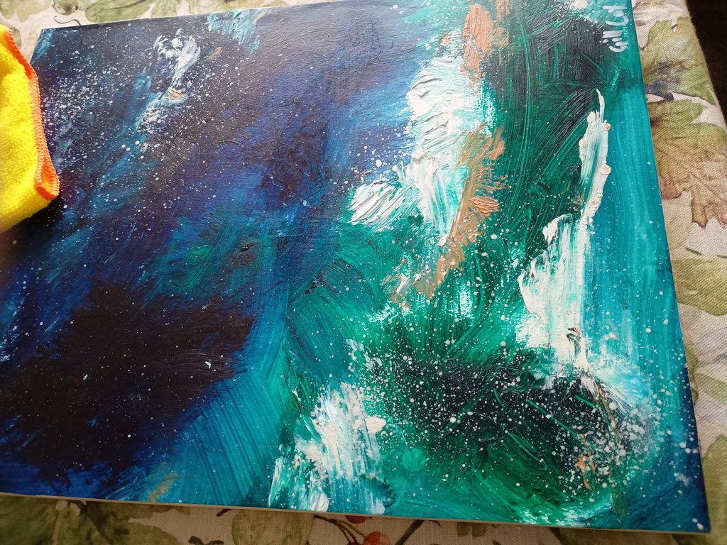

This is it after a buff just now on the cold wax layer that's been on for 6 months:

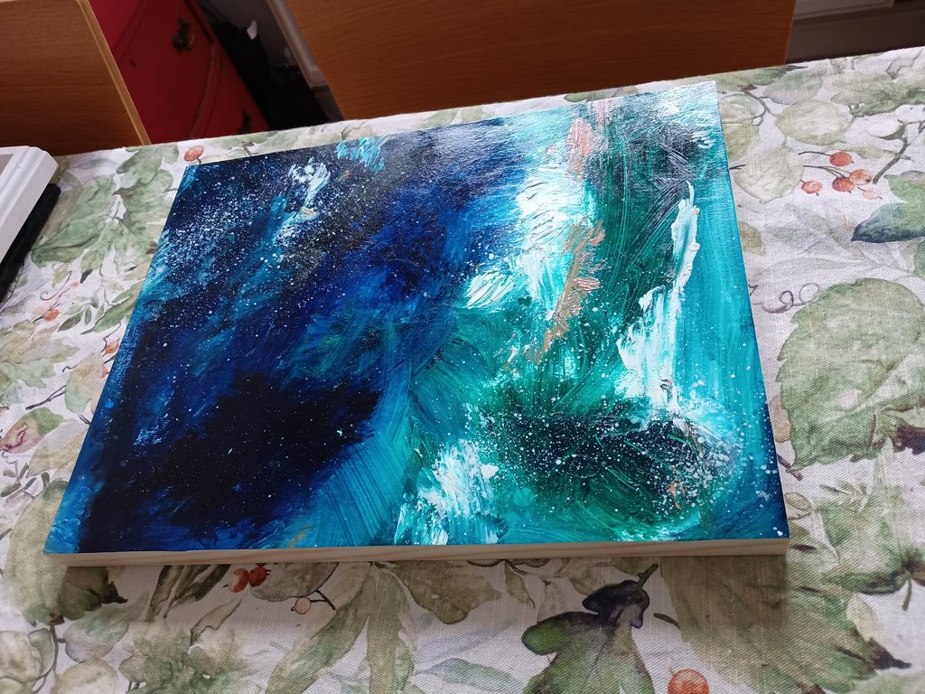

This is it after a retouching varnish just now = shiny:
First impressions, both processes are stable and protective.

Unfortunately for your client, I would say ink is not OK.
Only acrylic, and oil on paper. That's what I'd deduce.
By the way, I'm getting involved in this with a lot of interest, as a student of mine on a workshop wants to know how to do this, and I'm making tests for her for this Thursday. So I was doing it anyway.
I have just made a tester with a 1 yr old ink piece on paper (as in linocut ink rolled through a machine) onto mdf and rather strangely, the ink has lift away from the paper immediately I applied neat pva to the reverse.
It has undermined the work completely, even though it's been happily fixed and keyed to Fabriano 350g for a year. If they are using artist liquid inks in a bottle, I would be just as hesitant.
If the artist is asking you to do the ink and acrylic painting for them, it's a good idea not to, I'm afraid.
Picture to show you the smears, blobbing, and that lift off, hey it might reset, but I wouldn't bank on it:
