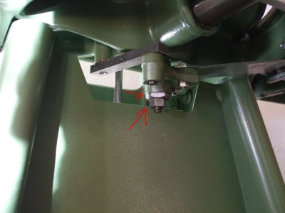

Under the front of the morso bed, you'll see a nut and an adjuster (see photo).
My procedure is to put the blades as if you were on the last but one cut, loosen the nut and adjust the blade so that if you have a bit of mountboard vertically against the fence, the blades just touch it (holding the blades down while adjusting). Tighten everything up again, and still on the second notch, try cutting the mountboard - it should just scratch the surface, maybe up to 0.5 mill deep. Remove the mountboard, bring the blades down and move to the final cut position. The blades shouldn't touch the fences. If they do, back off & readjust.

Sorry to but in on this one. I had a similar issue with a sharp Morso.
By spacing the moulding forward a couple of mm,it has stopped the damage along the rear edge.
My question is, are we trying to get the knives as close to the guide as possible without actually touching them?
and secondly , the adjuster underneath, is it a locknut and a cam? How does it adjust?
Thanks.

The blades of the Morso where they join in the point should JUST go into the groove on the back fence that marks the centre of the cut, BUT NOT TOUCH anywhere.
By putting a sheet of mountboard behind the moulding you are cutting you are in effect making the same adjustment in a temporary manner.
To adjust as per the earlier instructions, loosen the nut, grip the cam immediately above the nut, adjust, and then re-tighten the nut.

I have a spare set,and they are hollow ground. I just decided to adjust as per instructions, I moved the blades about half a mm towards the fence and bingo, perfect cut. I am chuffed to bits. I wonder if the previous framer/owner (no names) had problems with it. Anyway sorted and chuffed and thanks.
