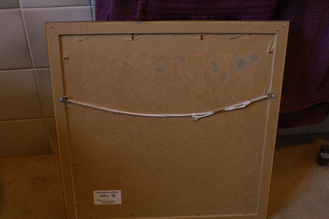

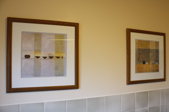

I've got two pictures in my bath/shower room (used every day and lots of condensation) that I framed 10 years ago.
Cheap Art Group prints drymounted, double mounted, stained and waxed ash frame and backed with...MDF :( and finished with gummed tape. Glass not sealed and back not protected in any way and they are perfect apart from some slight mould on the MDF on one of them which I have only just noticed as the have not been moved at all until just now. (I don't decorate much in my house!) The tags have begun to rust under the tape but then that is to be found on most old pictures.
pics 003.jpg (282.12 KiB) Viewed 3128 times
I used to seal the glass in with silicone sealer to stop the condensation creeping round the rebate but not sure if it's needed as these pictures show. If it was for a customer I might consider sealing to be on the safe side and the pro's and con's of bathroom pictures would be explained to the customer with no gaurantee given.
