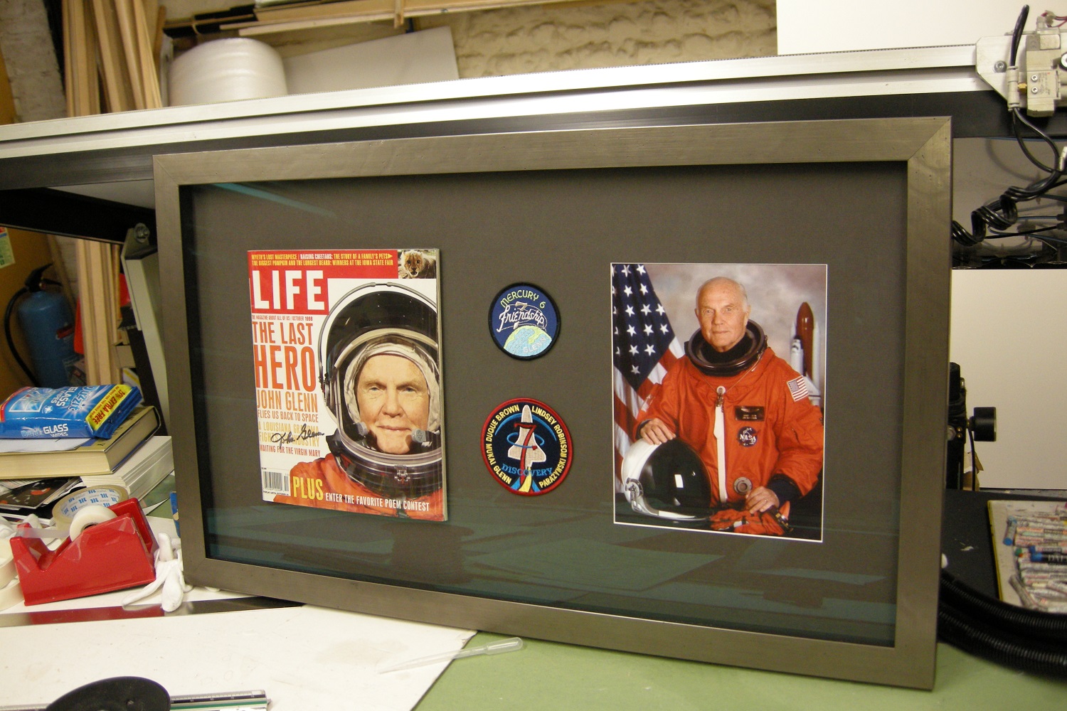

Post by Roboframer »
Mounting methods that is. Photo - Platform mount, badges - stitched, signed magazine - Melinex magazine/book mount.

Remind me again how the encapsulated magazine is mounted ? :)
Re: Three in one
See page 3 and page 9 here http://www.google.co.uk/url?sa=t&rct=j& ... NzgXL4Qn0Q But I have not passed the vertical sheet through the mounting board, both sheets wrap around the magazine and are stuck with DS tape to a board cut to the same size as the magazine and then that is stuck to the mounting board with PVA.

Nice one Robo, good choice of moulding.

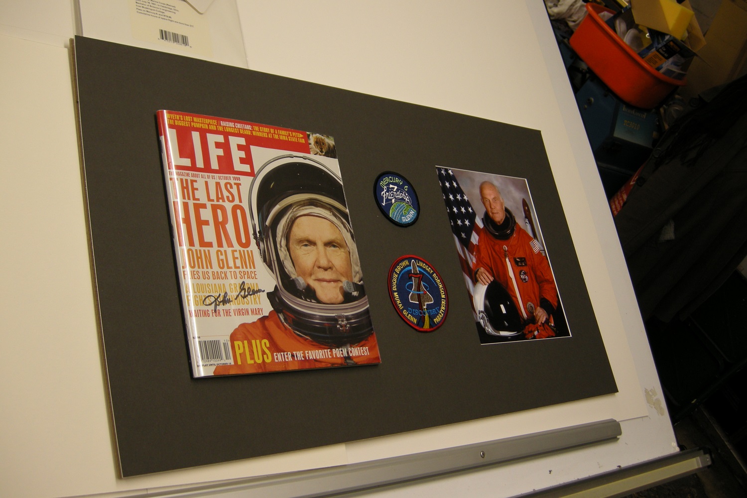

Can I just ask, did you stitch the patches onto ribbon/cotton tape, and then feed that through slots in the mountboard?
Re: Three in one
No, they're sewn directly on to the mount board, not all the way around like they would be if sewn on to clothing but about every inch. I have a home-made 'needle-awl' that pre-pierces the holes.
