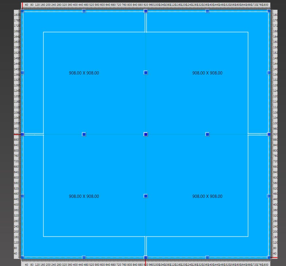

Valiani CMCs with Vstudio software can cut oversize mounts - in several pieces that are then joined. Ive never used the function but it looks pratical. The join is bevelled to create as clean a join as possible - would cost less than £300.
markw
Re: Large mount cut
Post by markw »
Valiani cmc would cut the large mount as four pieces.
image attached
screen grab of Vstudio layout

Post by IFGL »
I have used that feature a few times, it works fine especially with textured mount card.
