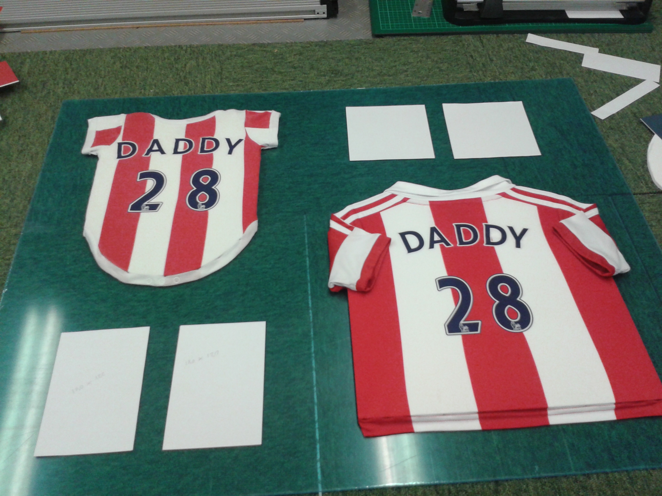

The planned layout
The planned layout
The planned layout
The planned layout

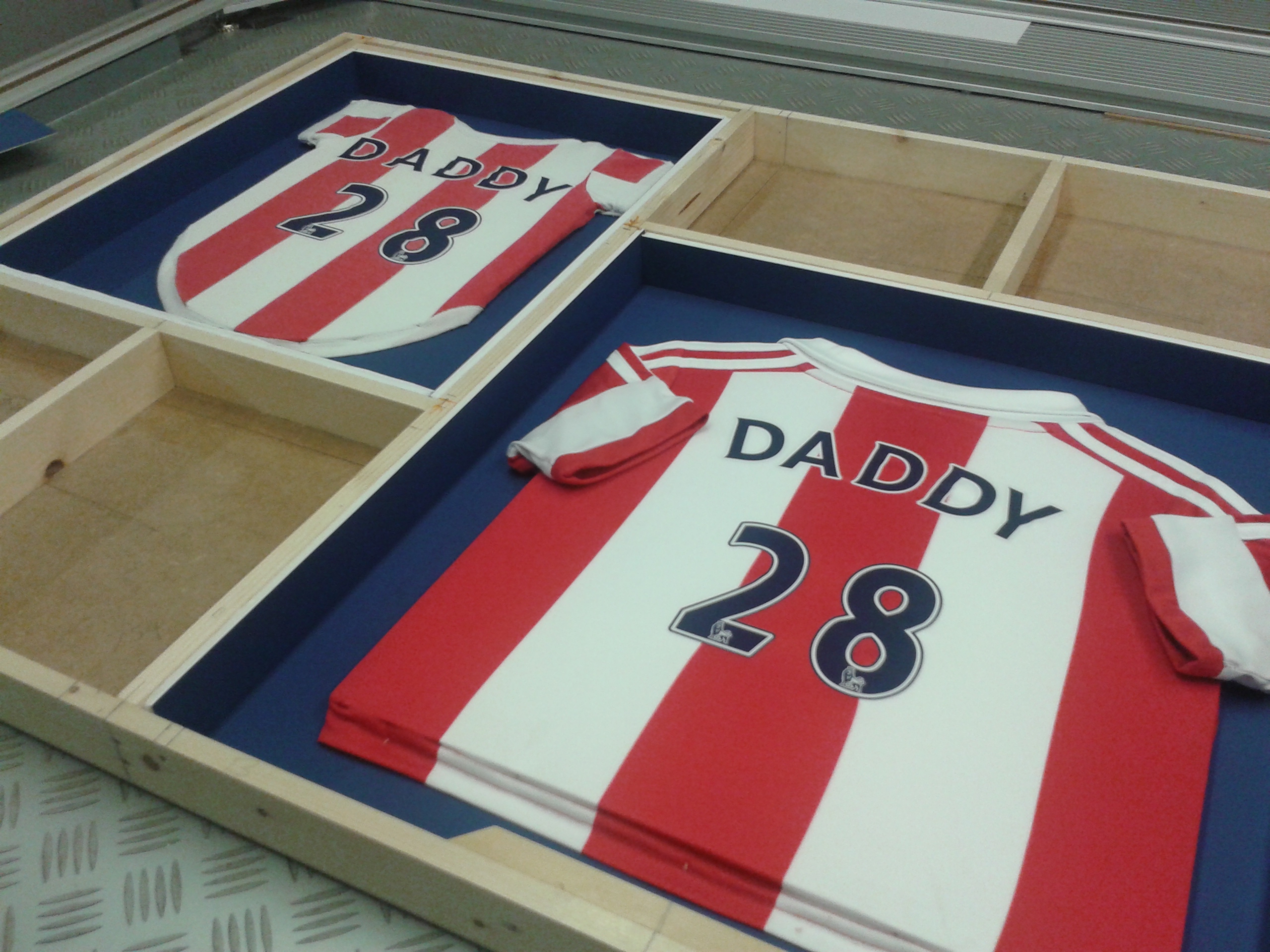

The continuation of the build

The size was determined by a cock up on a previous job. I had 3mm perspex cut incorrectly so it was put on one side ready for when the next job came in and here it is. The size is 988mm x 788mm - don't ask a weird size I know.
MDF was 2 or 3mm can't remember exactly, but the glued and pinned frame gives the job serious rigidity and then when you overlay the frame all is heavenly Deepjoy.
I used 2 'J' style hangers from Lion with 2 screws and rawl plugs per hanger. John Roboframer has posted a plan of weight based on the spacing of the wall hangers. The hanging string was looped 4 times to give it the over egged and safety factor.
The lining of blue mount board was attached to 5mm foam board by a laborious technique of tape, then glue, then tape, then glue, etc... The idea being if one fails the other will be there to stop it all coming apart.

Just one question, I can't quite tell from the pics, how deep is the moulding and how deep is the pine structure? Is the pine visible if you get round the side?
DEEPJOY
Posts: 562
Re: An Over Engineered Build
Post by DEEPJOY »
Thanks for all the kind words
I think the subframe is 12mm thick by 44mm and the mouldings rebate is around 30mm, I hope this helps :rock:
